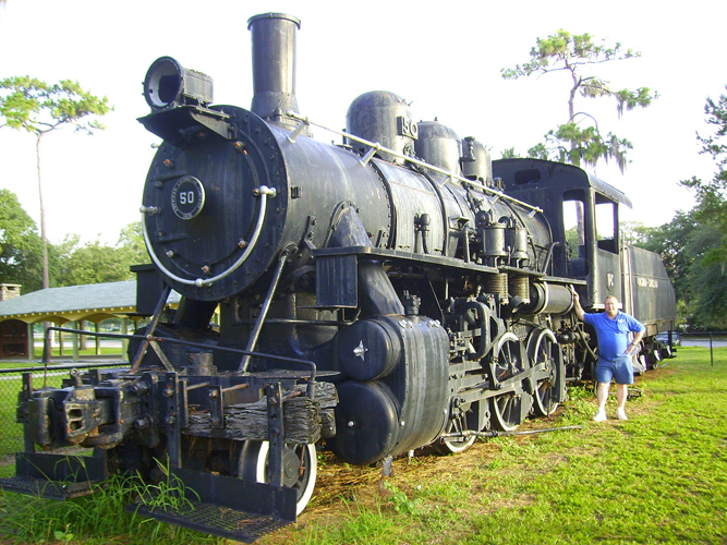

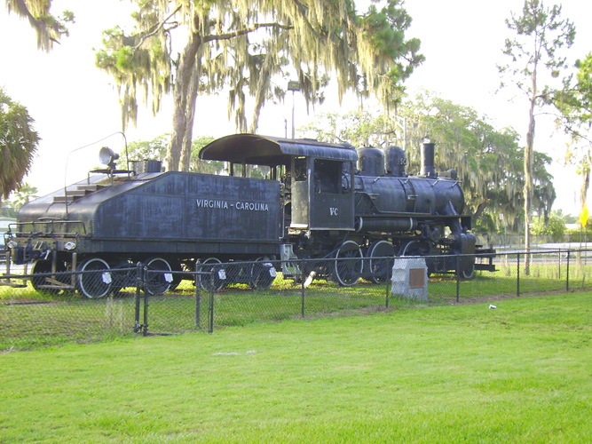

I am very pleased (giddy, actually) to announce that the city of Lakeland, FL has awarded the 2-6-0 mogul Virginia-Carolina #50 to the Alexander Chapter-NRHS. Last night I recieved and email from the city announcing that we were selected as the winning bid.
Now, while we have crammed narrow gauge wooden boxcars into standard semi-trailers and put Edwards Railcars on the back of a big ol' rollback, we have never tackled a full-fledged medium sized Alco.
If any of you have commercial contacts or interests in helping with this project, please email me via PM. If any of you have any nuggets of wisdom, CONSTRUCTIVE advice or questions that all RYPN'rs can benefit from, then by all means post it here.
What I do know is that the specs of the engine say it was about 110k lbs loaded with coal and water, that we will likely need a crane and two flatbeds. Lakeland, FL and our location of Newton, NC (about 40 miles NW of Charlotte) are both easily accessible via interstate and there are no landscape issues such as trees, hills, etc at either the loading or unloading site.
What are our plans for the engine? Well, the first part is to get her moved safely and then perform a cosmetic restoration. She will displayed under roof and not out in the weather like she has been for the past 50 years. Will she ever run again? I don't know, that's putting the cart before the horse. But if anyone ever wants to look her over, you are MORE than welcome....

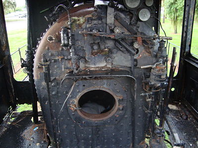

Remember, be fair to the homless man living in the firebox and post an eviction notice!

I looked at that loco awhile back.......did you look at the tender trucks? looked like somewhere along the way, they lost their journal brasses and wedges........... all the wheels are pretty bad too, years of sitting there in the pine straw has rusted them on the bottom at the railhead, bad enough that it will need new tires to be run again........When I looked at it last the homeless guy was living in the tender tank.......maybe he leased the firebox out to someone else?.......
With enough money, probably $300-500K.....it has some potential for operation...maybe......
 Post subject: Re: Assistance and advice sought for moving V-C #50
PostPosted: Thu May 19, 2011 1:51 pm
Posts: 380
Location: Hickory, NC
Well, maybe 200k-500k could make it run, maybe not.
Our first priority is getting the ol' gal under shelter and then polishing her up. The bottom line is that there is NOTHING like a steam engine to attract a a crowd. I would prefer to have a live one, but a dead one will work too (if its not in pieces).
I don't know much about the boiler, running gear, etc, or am I knowledgeable enough to intelligently comment on it, but I will say that the tender is shot. I dare say that if she were to run, the tender frame would be the only usable part.
The tender trucks do intrigue me... why in the world do the wheels have tires on them as opposed to cast wheels?? Seems like a lot of extra maintenance to me.
