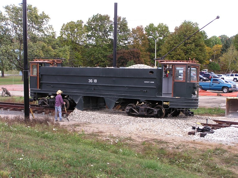

At Pennsylvania Trolley Museum, we do all track maintenance and some new construction in-house, largely because our 62 1/2 inch track gauge makes it rather difficult to contract work out. It helps that we have two crazies (including yours truly) who actually LIKE doing trackwork. Even when we do contract out new construction, we still need to do the ballasting and tamping/surfacing with our own broad gauge equipment. (The photo below shows us spreading stone on some contractor-built track using our Differential Car Co. bottom dump car.) But even just to get skeleton track built requires an extensive amount of holding the contractor’s hand so as to make certain we get what we want.
Word of caution: Specifications don’t mean a thing unless the track contractor's personnel who are actually doing the work have read and understand them. That’s more difficult than you might imagine. The track gang foreman may have graduated from high school but his laborers likely did not. Reading isn’t their strong suit. Typically, the gang will show up at the jobsite the first day having never seen a drawing or a specification. So, your first handholding exercise should be to sit down with the foreman and go over the specs and drawings line by line to make certain that he (1) understands what they require and (2) will pass along appropriate guidance to his gang. Next, you need to inspect their work EVERY DAY. You can't just wait until the next weekend and look at it then; it will be too late when you discover that half of the ties have been installed with the heartwood facing up and a third of the tie plates are the wrong punching or rail cant. Check all of the contractor's materials before he installs them to be certain they are what you bargained for. On one project, the contractor said he would be providing 100 RB rail. When the flatbed truck showed up, it wasn't - it was 100 RG (Reading) which is almost but not quite the same as 100 RB. He thought I wouldn't notice but a detail like that wasn't going to get past this Reading Company alumnus.
