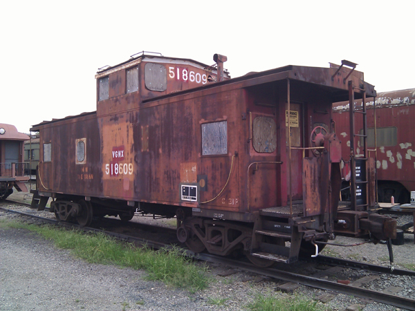

The 518609 prior to restoration:
After some metal repair last year, the body was media blasted to bare metal and then primed with 2-part urethane epoxy. After sanding the primer, the finish paint started with white over the whole carbody and then yellow in the areas where lettering appears. After that, vinyl stencils were applied for the heralds and lettering and the ends and body stripe were masked. The finish blue (also 2-part urethane) was applied over the past week and the stencils and masking were removed today.

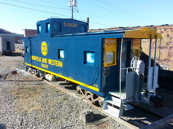

East end of the car with finish paint:

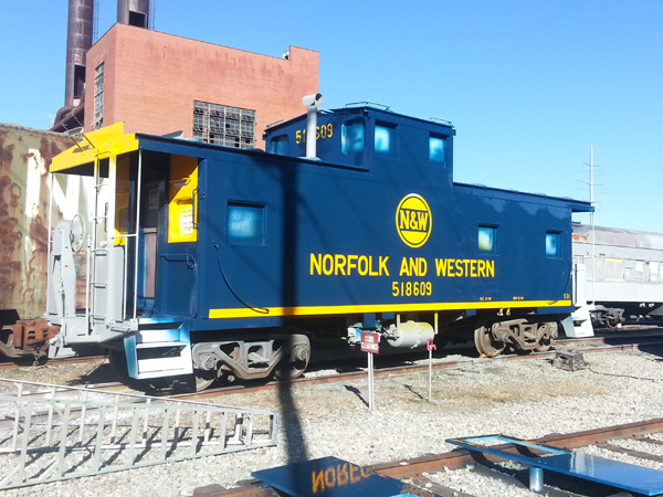

West end of the car with finish paint:
