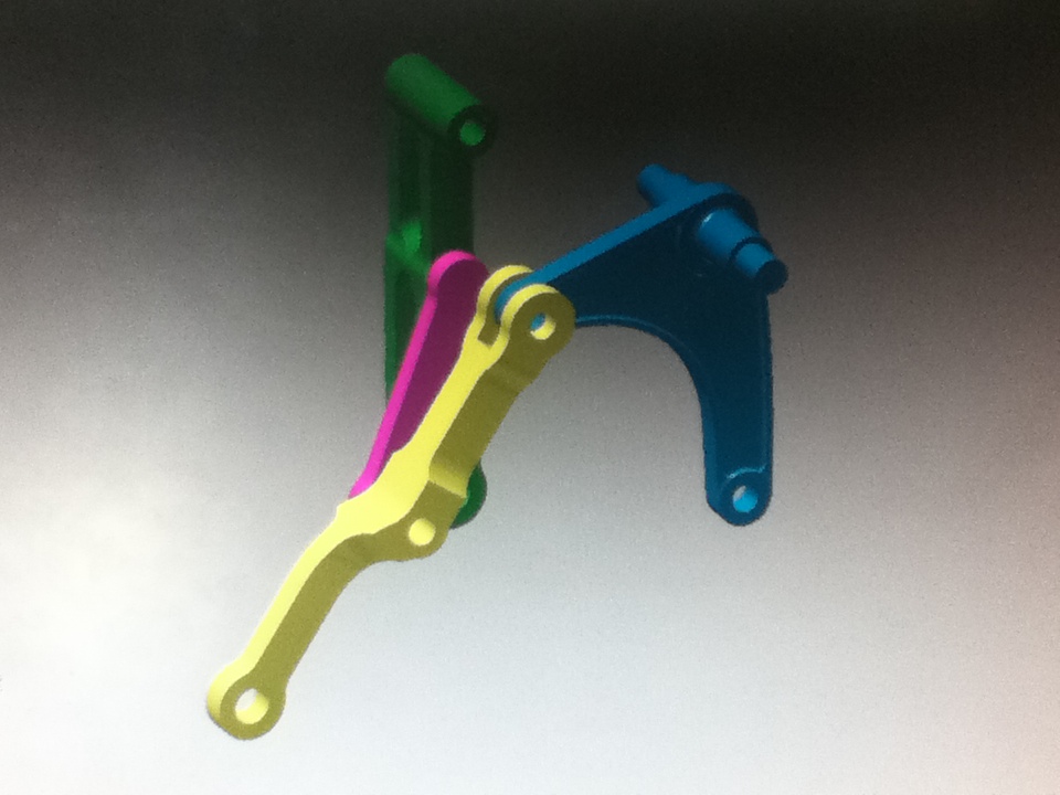

The simulation looks correct for inside admission. Everything is connected in the correct locations. The locations match my model.
File comment: some parts I made in cad for a live steam project
Stuart Harrod
