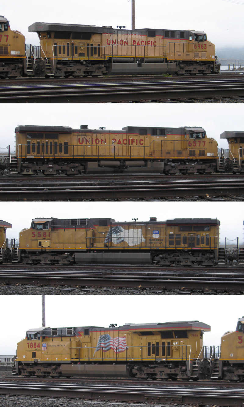

In an effort to help future historians, I carefully documented a string of four Union Pacific Locomotives. You are welcome to use them on future UP restoration projects to establish the exact shade and tone of UP Armour Yellow and Cascade Grey. Just doing my part for railroad preservation, no need to thank me..
I have the ability to shoot in raw, calibrate my images using a color target in the field, which is then adjusted using special software. Using a calibrated monitor and printer profiles, I can then print quite accurate photos.
But I didn't have time for all of that today, so I shot this in jpg with a point an shoot, and I'm uploading them to the web, so your browser can be sure to screw up the profile.

Also note the subtle variations in colors of the two american flags.

Not to mention the slight color shift in 5581's air conditioner.

On a more serious note, observe how all of the paint schemes on this random string of locomotives vary. Two have flags, two don't. The "Building America" slogan and shield are in different locations.
OK, but what about the top two, aren't they the same? No, they differ as well. On one, the top red stripe has a zigzag and it drops down. The other one does not.
Now, ask yourself this: How hard is it to imagine some future version of RYPN and an argument over "No, the shield was in front of the flag!" "No, it went further back on the hood!"
This is on the UP, where a casual observer could easily conclude everything was painted in the same manner except for the flag units. Now imagine BNSF with all of its variation and patch jobs!

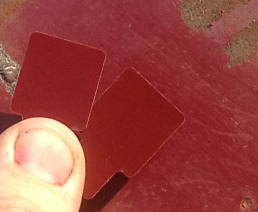

Munsell or functional equivalents are the only ones that work long-term. That is because they rely on the physics of light in absolute terms.
All the other systems - including Pantone - rely on specific, made pigments continuing to be available and continuing to be the same color. (how do the pigment makers get an absolute reference? Munsell!)
And pigments go out of production - ask your paint man, he'll tell you. When a pigment system gets changed, all those paint-store chips with colors like "Honeysuckle Rose" go in the trash.
You can't substitute an ancient pigment with a blend of modern pigments. Virtually all formulas are a blend, and your substitute pigments will interact in weird ways. What can I say but to try it? Go into your shop and find one of your custom "yellow"s that is actually a blend of several pigments, and a "red" which is likewise. Mix a teaspoon of each, do you get the robust orange you expected? No, you get a surprisingly dull and washed out brown.
As far as photos, forget about it. Here. Here's a photo of the car next to some Munsell chips, that's as close as we get to "not wrong", and can YOU tell? Photoshop is little help
