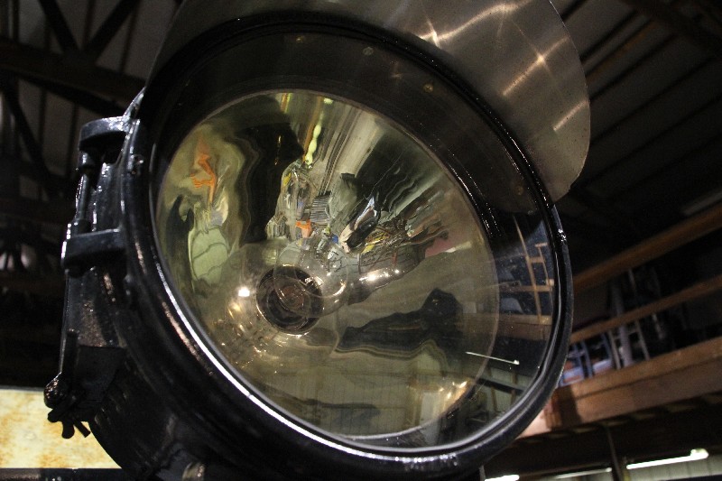

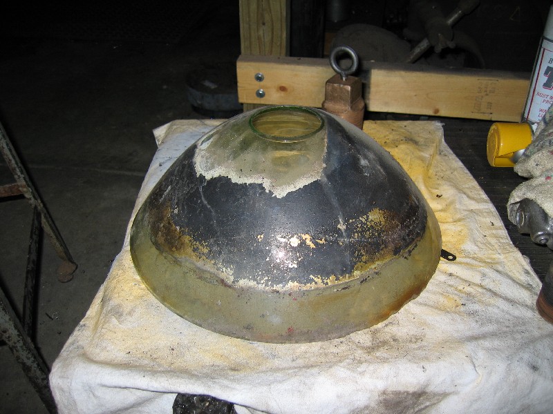

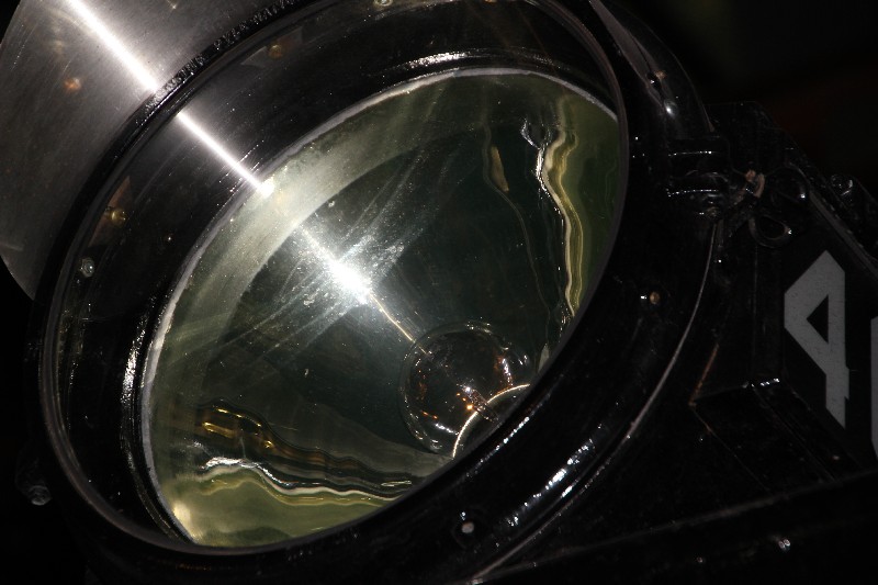

We've had one re-silvered for Southern 401's backup light, a 14" pyle. We had ours done at "A Moment in Time" in Wellington, KS.;
http://mirrorrepair.com/index.htm
File comment: This is what we had to work with, chipped up edges and lots of silvering gone.
File comment: The finished product installed.
File comment: From another angle.
You'll note the "ring" around the edge in the finished shots. That corresponds with the felt cushion that was behind the reflector. It had, over the years out in the weather, caused some etching of the glass where the felt had been. They were unable to make that any better than shown due to the problem being in the glass itself. Just like painting, if the underlying surface isn't perfectly smooth, the imperfections will be "telegraphed" though the finish. Other than this ring, which doesn't seem to affect the light's performance at night, they did a beautiful job of bringing this reflector back.
I can't remember exactly what we paid for the work, but I believe it was between $400 and $500, plus freight both ways.
