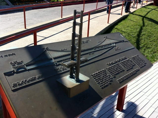

Our industry is hopelessly behind the times in complying with ADA. We can't just hide behind the "exempt" dodge because the equipment is old. While a specific piece of equipment might be "exempt," your museum and its programs ARE NOT. You must be able to provide an "equivalent accommodation." There are a lot of diverging opinions what constitutes an equivalent accommodation, but the spirit of the law requires that a similar experience is available for the disabled.
While all of your rail equipment may be historic, and therefore "exempt," the ride itself is not because it is a museum program. If you can't get the disabled on the train, you must do as much as reasonably possible to recreate the the ride through photos, video, audio, models, etc. A rental birthday caboose presents exactly the same problem. How do you provide equivalent accommodation for a disabled birthday guest? Warning guests in advance that the party caboose cannot accommodate the disabled may not cut it in a court.
There are no firm guidelines for these "equivalent accommodations." It is much better to be able to provide the same accommodation to all visitors, but extra effort is needed to take care of those with sensory disabilities. If you pay attention when you visit museums and national parks, you will see more and more exhibits designed for the blind or deaf. These might include recorded audio descriptions of exhibits, or scale bronze models for the visually impaired. Videos should have captions for the deaf.
Back to the exhibit in a boxcar... you must either make the boxcar accessible, or you need to provide the same exhibits in a place that is accessible. A compliant ramp that goes up the approximately four-feet to boxcar sill height would require 48-linear feet of ramp with a 5-foot landing that the bottom, a 5-foot landing in the middle, and a 5-foot landing at the top. A wheelchair lift might be a better alternative than 63' of ramps and landings. There are a lot of additional requirements that address door hardware, thresholds, corridor widths, handrails, etc. ad nauseum. This stuff is not a place for "gitterdun." The requirements for building accessibility are very specific. Make sure you are doing it right from the start.
File comment: Golden Gate Bridge
