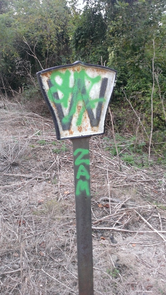

A quick brief on my situation:
I volunteered to restore this whistle marker since... Well... It's obvious. This is a first for me and I was wondering, did the pole into the ground have paint at one time? the marker head was repainted sometime in the last 50 years but the pole itself is too deteriorated to tell if it did or didn't at one point. Any help is appreciated.
-Chris B.

Quick and dirty answer: Yes.
I've removed a couple PRR variants of this kind of sign for restoration at a local auto body shop--a quick wire brush and/or sandblast, primer, and paint and you're good to go. Spray paint for the primer and black base, then white gloss by brush.
I've seen two short line railroads restore their original whistle posts. But mind you, they placed them on solid steel posts set in concrete, then spot-welded the (removable) signs themselves to the posts.
I think these B&O signs are solid units, so it's up to you to decide whether to dig them up and take them to a shop or work on them in the field. You may not want to make them look too good, lest they catch the eyes of vandals or thieves.

I was told about that by some other volunteers. Upon digging, the B&O had these in about 300 lbs. of Concrete 2 feet down. It wouldn't be a problem to have to repaint them if someone tagged it but the chances of them being stolen are low. The area is very nice and the signs sit around a house. The neighbors are real nice to the railroad. I'm sure if someone was down there with a saw/truck/hammer/loud device, they'd do something about it.
As for the actual restoration part, I have everything set up and ready to go. I know the one pictured will be a field job, thanks to the dead brush. As for the other, some say take it out, some say keep it.

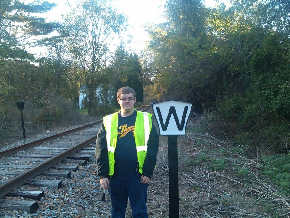

End result of West Marker!

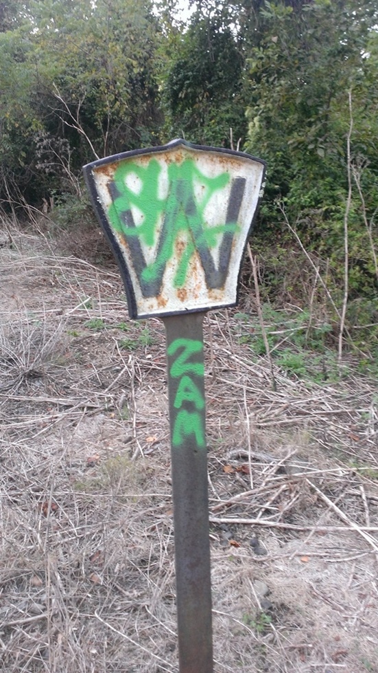

You forgot the green spray paint that says "zam".

PostPosted: Mon Oct 14, 2013 10:03 am
Chris -
You done good. Congrats!

PostPosted: Mon Oct 14, 2013 7:35 pm
Joined: Wed Apr 24, 2013 10:17 pm
Posts: 96
If you're referring to the slight fade in the paint, we weren't done detailing. I took this photo just before the sun dropped below the valley. I promise it is gone now.
As to everyone else, Thanks!
- Chris B.

PostPosted: Mon Oct 14, 2013 10:16 pm
Chris, no. I was teasing you, in a good natured way, about the spray paint vandalism that appeared on the post prior to restoration. You've done a fine job with that artifact.
