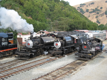

Robert Dollar #3 (1927 ALCo 2-6-2T) was close to 30 years and two owners. The Western Railway Museum (WRM) began restoration of the #3 in 1979. Over the next 20 years the WRM completely disassembled the locomotive and did a tremendous amount of work to the locomotive, but was unable to reassemble the locomotive. In 1999 the #3 was acquired by the Pacific Locomotive Association (PLA) and moved in pieces from Rio Vista, CA, to Brightside, CA. PLA began work on putting all the pieces back together. Eight years later in February 2007 the #3 moved under her own power for the first time since being retired in 1959.
The #3 has proven to be a strong and reliable powerhouse (after a lot of tweaking) on the Niles Canyon Railway and operates along with two other steam locomotives, Quincy Railroad #2 (ALCo 2-6-2T) and Clover Valley #4 (Baldwin 2-6-6-2T).
Johnathon
File comment: PLA steam, 7/4/2013
