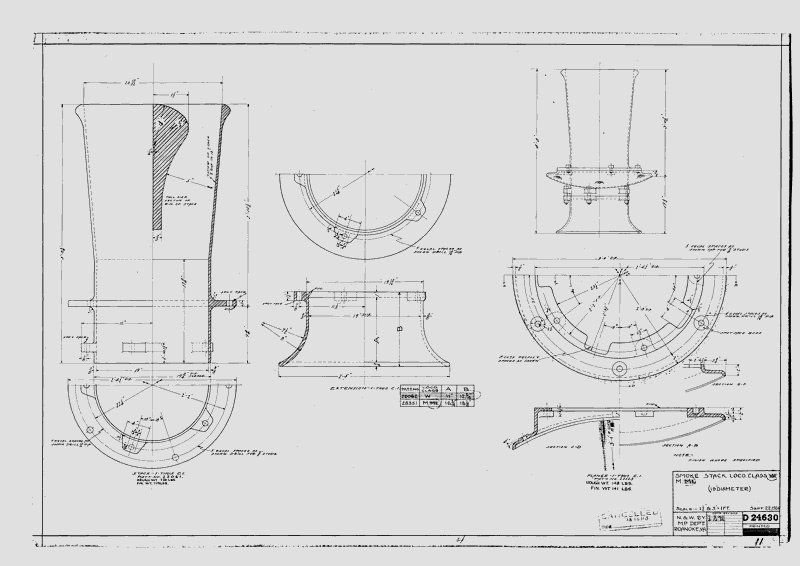

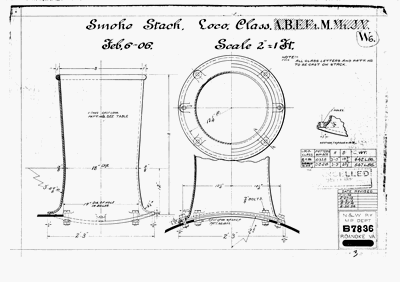

As an exhibit of evolution, I found the original drawing Kelly referred to for the M detailing no petticoat though I wouldn't call it a "shotgun" stack..... it's got a decent taper. Note that drawing has been stamped "cancelled".
The second drawing is the one which replaced the first, is from the mid twenties and does have a modest petticoat. With understanding and this acceptance comes evolution in design I guess.
