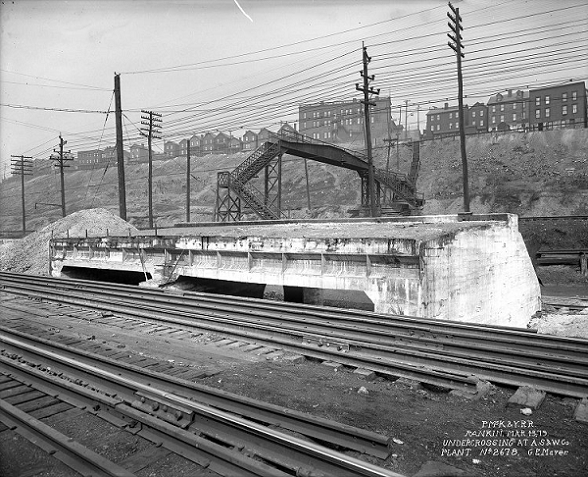

Here is another bridge that appears to be using inverted turntable girders. This one was over the B&O mainline in Rankin, PA.
I will be in the Silver Spring area around Thanksgiving. I might just stop by this bridge and take a look. If those spans were used on a turntable there should be some extraneous components and/or punched holes left over from its former use as a turntable.
