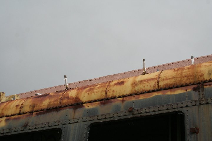

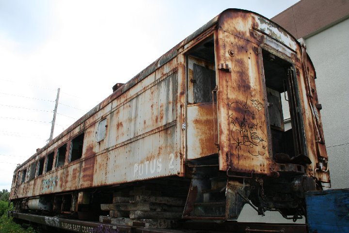

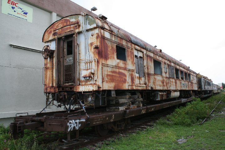

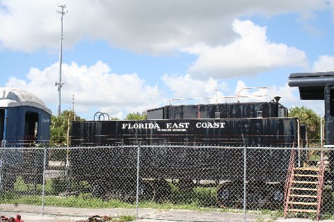

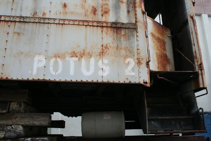

I would like to share current photographs of the exhibit and how it looks today, on a siding in Hialeah Florida.
You can made the determination for yourself if the money was properly spent on the preservation of these two cars. Also note, for the record, how the cars are identified ( POTUS 1 and POTUS 2 )...

Potus 1 ( or US 1 ? )

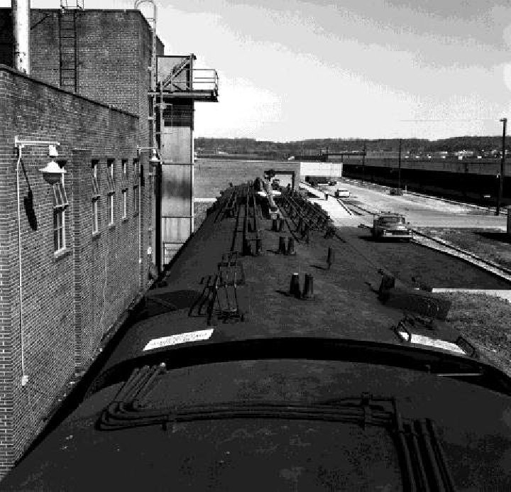

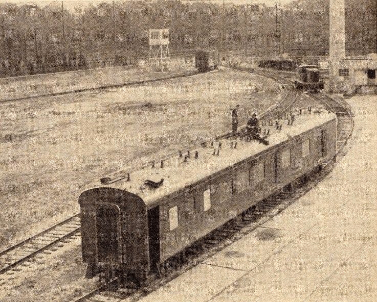

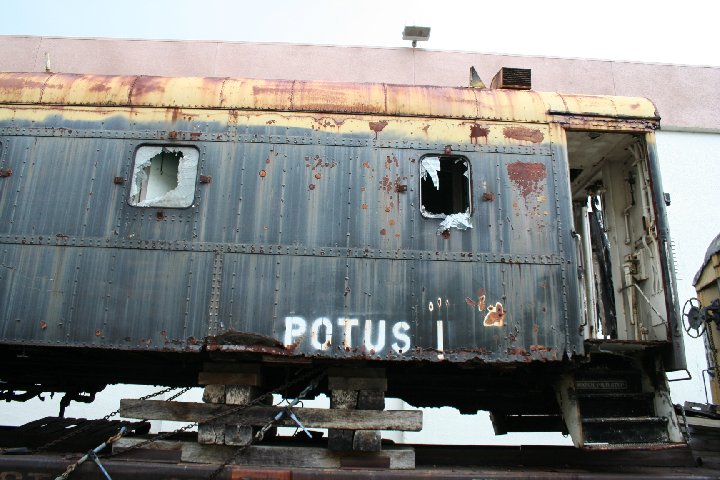

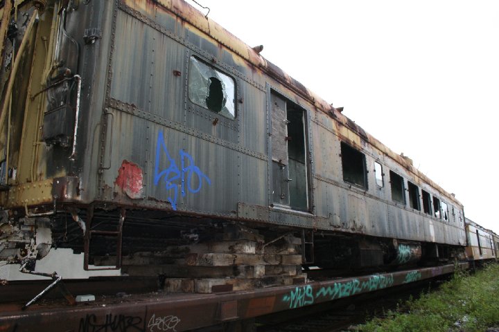

...and to conclude, it would appear from window pattern that the car identified as POTUS 1, likely did serve, when comparing window placement. As mentioned in the main text, the antenna was a complex system for its time. Note the overhead picture of the car in service, and the remains of the antenna system today. One of the antenna brackets was on the ground in the weeds next to the car.

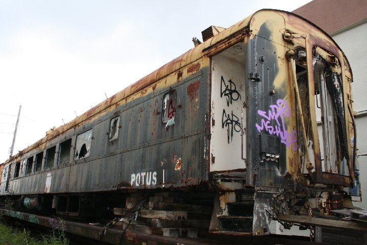

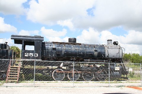

On a side note, the Florida East Coast 253 ( part of what perhaps was supposed to be part of the display as previously discussed at the Dorothy Walker Bush Museum in Hollywood ) sucked up another substantial sum of State of Florida money with what many might think are perhaps questionable results to date, given the desire of the group to see that locomotive operate.
Also note below the name of the groups associated with these grants.
Florida East Coast Railway Steam Locomotive #253 Gold Coast Historic Railway Foundation, Inc. Miami-Dade $218,100.00
and then later
Florida East Coast Railway Steam Locomotive #253, Completion Phase Steam Locomotive Association #253, Inc. Dade 2008 $48,000.00
These grants were again issued by the State of Florida Deparment of Historical Resources ( the same department that tossed away the money on the Seneca Valley, CG combine and Southern RPO ) ... Add it all up in South Florida and I think we are at approximately $1,250,000.00 possibly spent with not much to show for it, and $1,000,000.00 of the money came from the State of Florida Deparment of Historical Resources...
Now, what could you preserve if you received state and federal grants in excess of $1,250,000.00 ?
And speaking of FEC 253, here are the results of $266,100.00 ( which is not per say a reflection of this group ).... and of course $266,100.00 is just from the Department of Historical Resources.

I didn't want to imply the money was in theory "wasted" on the FEC 253, its just when you go to Ft. Pierce it does not per say look like a place where a steam restoration is ongoing. Now with that said, it would appear that one of the driving forces of this operation, Steven L. Spreckelmeier, unfortinately passed away this year. I likely believe that his death likely caused great hardship for this all volunteer group, and from what I can see, the operation in Ft. Pierce is more like a weekend siding open for tours to an occasional visitor. I also stated that the grant money for the 253 was issued to two different receipants, which makes you question what happened initially.
Perhaps time will tell, and their progress will show results like the tremendous efforts and accomplishments that were performed on the CNJ 113. However, in the case of the $266,100.00 that was extended to the 253, hopefully getting out of Hialeah ( which I am sure was a gigantic effort ) helped, however with limited funding, outdoor Florida conditions, and one of the leaders of the group unfortunately no longer present, one can only hope at this point.
Granted I am not a member of the group... however their Facebook page has no information about the locomotive and I believe last had activity a year ago, and their web site for the locomotive does not seem to open.

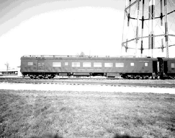

The attached black and white photograph show the General Myer ( I believe the car identified now as POTUS 1 shown earlier ) ..shown at the U.S. Naval Gun factory in Wash.DC.
DL
Donald Nichols wrote:
In it he (W8SU) wonders about the fate of the Myer and the Crew Car Morn. Both still exist. At present they are at the center of a felony investigation with one person already under arrest. The person in custody applied for state funds for the cars' restoration. However nothing of the such was done and that is where felony theft charges come in. Due to the legal problems, nothing is being done for the Myer and so it is going downhill fast. I last saw it in October and believe that it is now beyond being able to be saved. One of the set of trucks for it or the Morn were scrapped and another sold to another group. I don't know if it was the Myer's or the Morn's that were scrapped. I was the person who arranged for it's saving back in 1987 when NASA had it up for disposal, and worked on it when it was at the Gold Coast RR Museum. I also went to Steamtown as a consultant when the museum was going to have it restored using FEMA funds for damage caused by Hurricane Andrew.
Morn is the crew car for the Myer. It was built out of Hospital Unit Car USA 89426 and carried 87426 in Presidential service. W3WTE operated out of that car. It was later replaced by 89501, a Hospital Ambulance Car built in 1952 as part of a 52 car order as a replacement car for the Morn, Myer, and 50 other cars sent to S. Korea.

The car labeled as "POTUS 1" is in fact the Gen. Albert J Meyer, SC-1 a communications car that always accompanied the Magellan once the leased B&O combine 1401 was retired. This is well documented online and in Bob Withers book, "the president travels by train" on pages 136, 276, 384, 390, and 395-397. Page 276 also mentions the communications crew car that served as a dormitory for the Meyer's crew. This was also a former Army Hospital Car, and very likely the one labeled "POTUS 2." I also have some archival information I gathered from Ft. Eustis library when I visited there several years ago supporting this.
The window and door arrangement on the car labeled "POTUS 1" unmistakably identifies it as the Meyer, the other car would take more deeper investigation to prove its lineage.
However I offer this, in my research travels I went to Steamtown in Scranton where the CGRM's hospital car 89436 was restored and have spoken to the guys to performed the restoration and obtained copies of all the materials and information used from the archivist there.
At the same time 89436 was at Steamtown, so was the Meyer and its accompanying crew car, now labeled "POTUS 2." I have photos of all three cars at Steamtown being unloaded from the flatcars to be restored. For whatever reason, only the 89436 was restored and the other two have ended up in Miami in the legal mess they are in now. I personally would love to see them restored and on display at GCRM with the Magellan.
