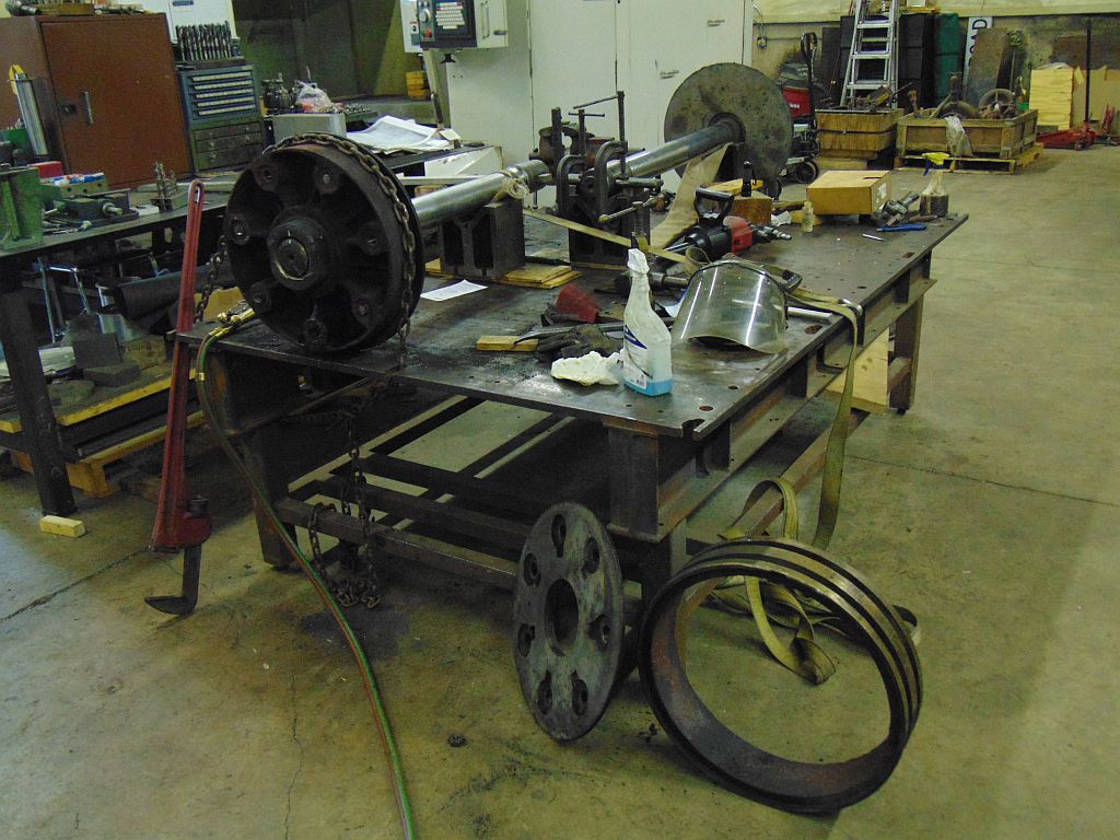

As a side note the pistons we're dealing with are not contoured like the Baldwin and actually use a front and rear plate to capture and seal around the bull ring. Here's a shot of the disassembled piston.
File comment: Piston Ass'y.
More detail can be seen here: https://www.midcontinent.org/category/cnw-1385/page/2/ .......mld
 Post subject: Re: Steam Piston Rings
PostPosted: Sun Dec 09, 2018 7:23 pm
Ah..... a built up piston. When I was in Australia many years ago, a 3800 class was in test runs in primer and developed a blow across the piston - turns out a rivet holding the piston assembly together had broken and was blown out through the valve and out the stack without fouling anything on the way, and landed on the running board. I stopped in and helped pull the piston the next day - beautiful machine, welded saddle, everything done first class. Very lucky, too...…..
Double check your rivets and don't drive them cold. Not everybody will be that lucky.
