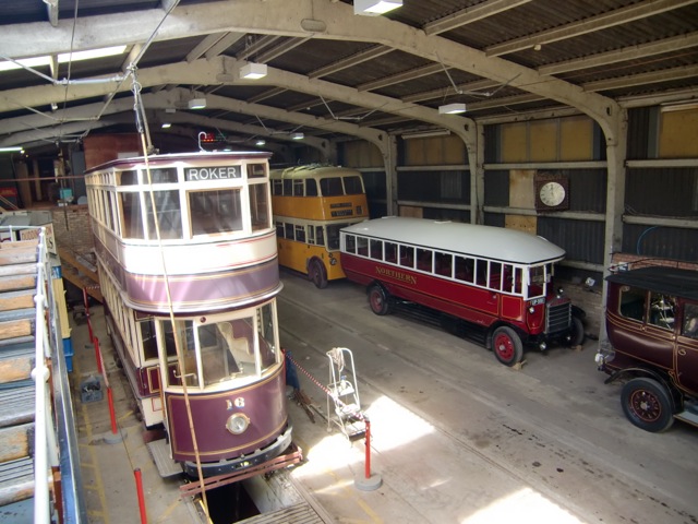

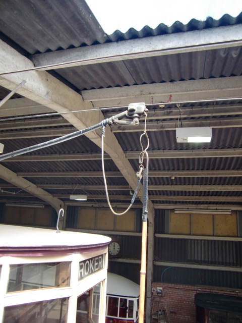

One of the main differences between the USA and the UK systems, is the UK generally uses what we know where as a swivel head type trolley harp, which allows the shoe itself to swivel 360 degrees (I cannot speak to what trolley head arrangement the PE had in their terminal). It also meant that all the trolley frogs all need to have a mechanism in them to change the direction of flow at track switches. Also, when using a swivel head trolley harp, it is not as critical that the over head wire be as close to the center of the trackway or off set towards the inner curve.
Generally the swivel harp arrangement is found in use on trolley coach systems. The other issue is the pole itself is generally insulated from the overhead contact wire volatge.
Attached are two photos taken in recent months in "Beamish" which is a large out door museum. It shows the bamboo pole and how it is attache to the trolley pole, and another showing the length of the bamboo pole.
Cheers--Karl Johnson
