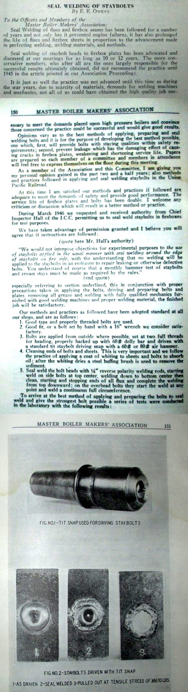

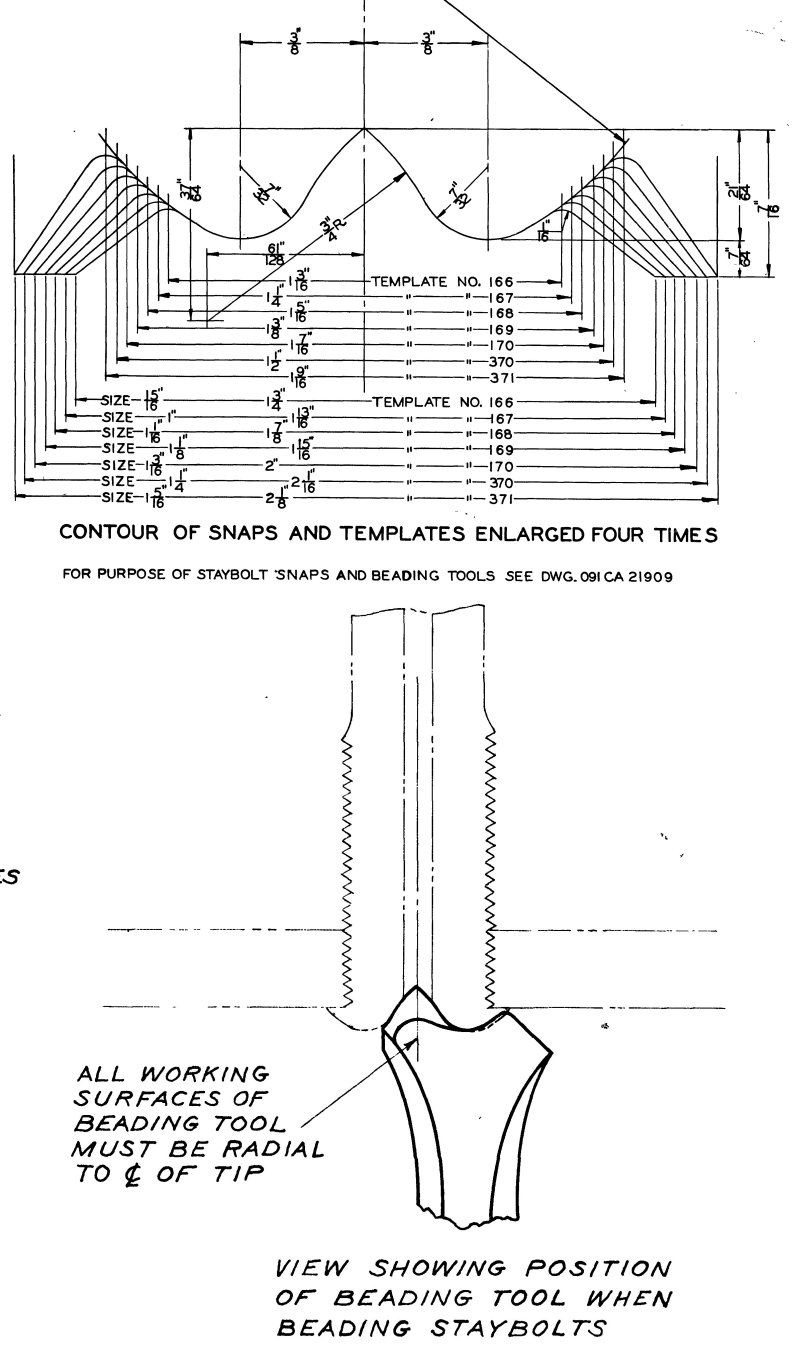

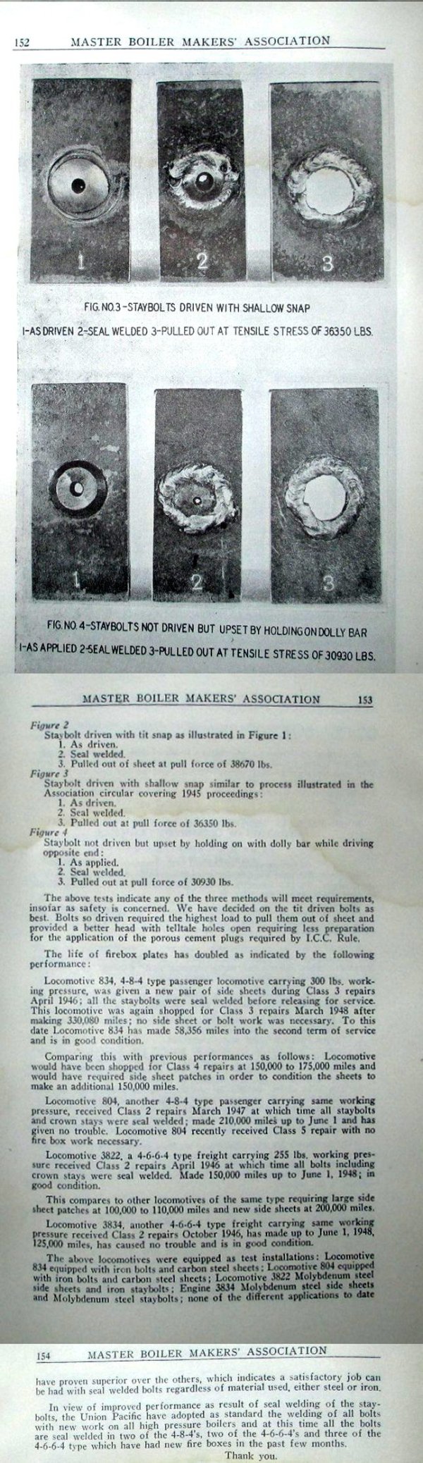

Well, this is Union Pacific staybolt installation procedure as described by Elmer E. Owens, Master Boiler Maker of UPRR - 1948.

1) Tit snaps and "merry go rounds" as per the drawings work best with wrought iron or very soft steel staybolts such as A-31 (if at the low end of the carbon range of the specification). Some railroads used a steel referred to as 2210, which I believe were 10% carbon content, hence very soft and easily driven.
2) It did not appear to me that the bolts on the former M&NF No.14 had been driven prior to welding (unlike the UP procedure). Not saying that it won't work, but I question whether the bolt will upset into the sheet after being heated red hot.
J) Stathi Pappas obtain very nice results with a merry go round on Sierra No. 3's firebox.
J.David

Thanks for providing this. Unless I'm misreading it, though, the report is silent on what method of post-weld stress relieving was done... if any. Are there other contemporary reports from the MBMA or other sources that indicate how this would have been done? (I'm presuming that the logic was that because this was a 'seal' weld, the HAZ would be so slight as to make normalization of weld-zone stresses cost-excessive.
I do note some interesting detail about how the seal weld beads failed in the pullout-test pictures...

I re-read the post by Matt regarding UP practice as reported to MBMA. The tit snap illustrated in Fig 1 is different than the drawing of the beading tool/snap included as a separate attachment. Which one was used? Was this simply a mis-print? Anyone driven bolts with a snap as illustrated in Fig 1? Obviously, Stathi's driving of bolts on Sierra 3 was with the snap/beading tool shown in the drawing. Comments?
Also, I ran across another video of heating before driving on a different locomotive. I cannot tell if they are welded prior to driving. I will say that they do not appear to be heated as much as the ones in the photos posted. Again, where did this heating of bolts come from? It seems to me it would be a leaky bolt from the start once it cools down. Also, I thought seal welding of bolts was done only on the fireside or interior sheets, not on the wrapper side?

There have been a number of questions raised, I'll give some answers/opinions in no particular order:
49CFR Part 230 does not specify how a staybolt is to be installed, it is the result that counts with the FRA (read: no leakage at installation and in service). NBIC rules are rather like a cookbook with methods of installation specified.
There are at least two types of tools which can be used to install staybolts and get that nice rounded head: the tit snap and the merry-go-round. Either will produce a nice head (AND a leak free staybolt). I have used both: the tit snap with a No.60 riveting hammer and the merry-go-round with a No.200 chipping hammer. But, but, but remember, the staybolts were wrought iron or NOS steel bolts. At this time (I'm older) I would need someone backing up my elbow if I was going to drive bolts with a tit snap.
Watch how quickly Stathi drives staybolts in the video: those staybolts were soft, probably 50,000PSI tensile steel with low carbon content (maybe 15~20%?).
I would GUESS that staybolts in No.14 have a much higher carbon content/higher tensil steel, and to drive them, per se, let alone have a pretty head on them, heat was essential.
A semi-digression: when we did the side sheets and door sheet on our (Valley Railroad) No.40 several years ago, I bought a couple of tons of what was supposed to be 60,000PSI steel. Well, the range allowed by ASTM goes up into the 70s' and this stuff was right up there. I refused the load, they took it back and annealed it, bringing the tensile down into the mid 60s'. Even at that, those were tough bolts to drive. We ended up upsetting them with a No.60 riveting hammer. Some of the guys were strong enough to finish the head with the No. 60, I couldn't, I had to turn over the edge with a No.200 chipping hammer. Of course, we were heading them up cold.
Our practice is to leave 3 threads exposed from the sheet for heading. The bolts on No.14 appear to have 5 threads exposed, way too much, in my opinion to upset into the sheet. Or for that matter head up at all cold.
Now, all that said, is the method used on No.14 going to work? My guess is that they will have no problem getting through their initial hydro. What I question is the long term viability of a staybolt that isn't tightly upset into the sheet. If it isn't tight in the sheet, scale will build up between the (loose) threads and eventually the weld will crack and bolts (not all at once) will leak, and will prove to be unrepairable because there is no way to get scale out from between the threads (of course you can change out the staybolt). Now perhaps with the head of the bolt hot, the threads will upset into the sheet. I have never tried or heard of this method, I don't know.
There is a reason why you prove tubes (or staybolts) tight BEFORE you seal weld...
Be well,
J.David
