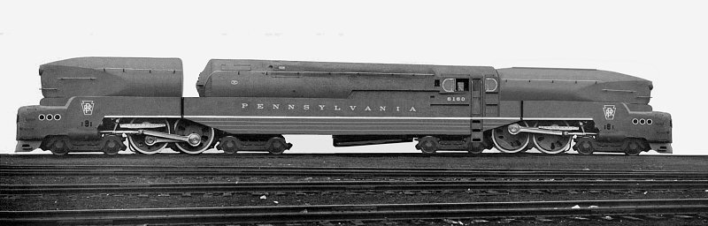

What if the Pennsylvania Railroad's T-1 duplex had been a Garratt instead?
www.railarchive.net

 Post subject: Re: Regarding Garratts...
PostPosted: Thu Aug 08, 2013 8:32 pm
All kidding aside, if PRR had made a Garratt out of two Pacific underframes, like a larger version of the Algerian locomotive, it would likely have been more successful.
Imagine running gear similar to 5399 or 3847, but with smaller cylinders and perhaps reduced stroke (driver assemblies and some balance concerns common to T1s?). Abbreviated tender (with coal in the front section transfer-feeding into the bunker, and water transfer-pumped to the front for tractive-effort control there).
Sure, it's relative overkill for a passenger locomotive. But it DID represent a 'modern take' on the traditional PRR "locomotive" for heavy trains -- doubleheaded K4s...
If I remember correctly (it has been a long time!) there is a file in the N&W archives that covers contemporary alternative forms of motive power, and the Garratt and 'Garratt-Mallet' designs are included there...
If that had been the case, then the Pennsy would have been unique in that they would have been the only North American railroad (to my knowledge) with double-ended steam and electric locomotives.
But, alas, no Pennsy Garratts...oh, well...
