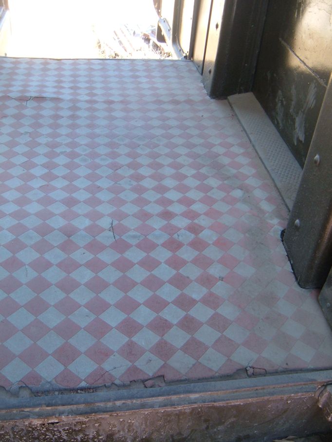

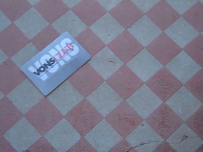

Here are a few of pictures taken of the vestibule and steps of the 1915-built Pullman CORYDON in the collection of Orange Empire Railway Museum. The car was sold to one of the movie studios in 1944. The pictures were taken today (Sunday Aug 4th).
File comment: This shows the diamond pattern of the vestibule floor.

File comment: This detail view shows the pattern and the size. I did not have a measuring tape with me so I laid down a credit-card-size grocery card -- you can scale the size.

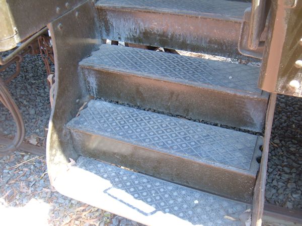

File comment: This view shows the Pullman step treads, etc.

These tiles have faded badly...the were originally were very dark green and terra cotta red. Nobody makes (nor will make for you) this pattern. You will need to get some 12 X 12 tiles and cut them down to the size you need. Then they should be glued to a thin sheet of some sort...to make a mat. The originals were glued to a rubber mat, good luck finding that. The mat is then cut and glued down. It's a lot of work but well worth the effort.
T7

Depending on thew thickness, recycled conveyor belt might be just what you need to back thinner modern tile. It's certainly resilient.
dave
 Post subject: Re: Pullman Car information needed
PostPosted: Tue Aug 06, 2013 12:42 pm
All kinds of rubber sheet goods available from McMaster Carr that could work for the backer sheet; more difficult to find colored material for the show side. Might be easier to replicate with vinyl flooring products; colored squares bonded to vinyl sheet flooring.
Harder to find are going to be those step tread plates. These were cast iron, IIRC, with some sort of hard grit inclusions to yield a non slip surface that never wears out. This is likely still available in a straight line or check pattern, but the "bulls-eye" dots are distinctive. Nystrom has some cast plates on the last page of this catalog:
http://www.nystrom.com/ftpgetfile.php?id=3057
Don't know if they are available without the nosing lip.
On Edit: This outfit seems to offer a good selection of flat tread plates, Type 100, from 6" to 12" deep, should be something usable, but not the correct pattern:
http://www.thematking.com/business_indu ... s/into.htm
Try searching "cast iron non-slip stair tread, threshold".
By the way, as old as these steps are, they are likely not the original, until the twenties Pullman only used three tread steps.
Dennis,
You're correct about that. The change occurred in the mid-twenties and then earlier cars were rebuilt with the new configuration. More information can be found here on Thomas Madden's Pullman Project website: http://www.pullmanproject.com/Steps.htm
I suppose IRM's Pullman Library has drawings of both configurations.

You will NOT want to use vinyl (as suggested by somebody else), it will crack/break easily and discolor rather quickly. Overall vinyl will not hold up to the elements. The colored rubber tile is readily available (search on the internet) in 12 X 12 squares. The rubber will last for a long time without cracking.
They make a guillotine style tile cutter but I can never find one when I need one. Use a straight edge, utility knives and lots of patience to cut the rubber.
T7

Can't say I disagree... I was thinking vinyl might be easier to source in the proper colors, and would likely hold up OK in the interior, but UV exposure will kill in in the vestibule for sure... the floor will end up looking like an old cracked dashboard in a matter of years. Take Termite's advice and find the proper colors in rubber tile.
