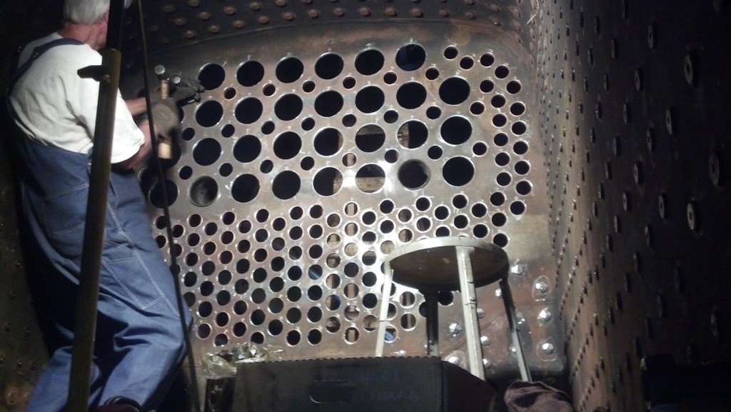

The clock has started. Two superheater flues were installed in 4501's boiler last week. The boiler tubes are now being cut and placed in the boiler. We also made a decision to replace all but 6 of the original Huron Washout Plugs due to the condition of the sleeves. These remaining 6 original plugs have had their seats cleaned up.

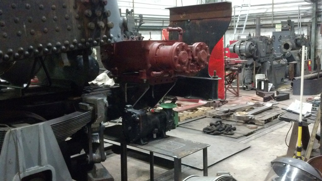

The mount for the stoker engine is now complete and welded to the frame. The cold water pump location has been determined and fabrication of the bracket is in progress.

File comment: First boiler tubes installed

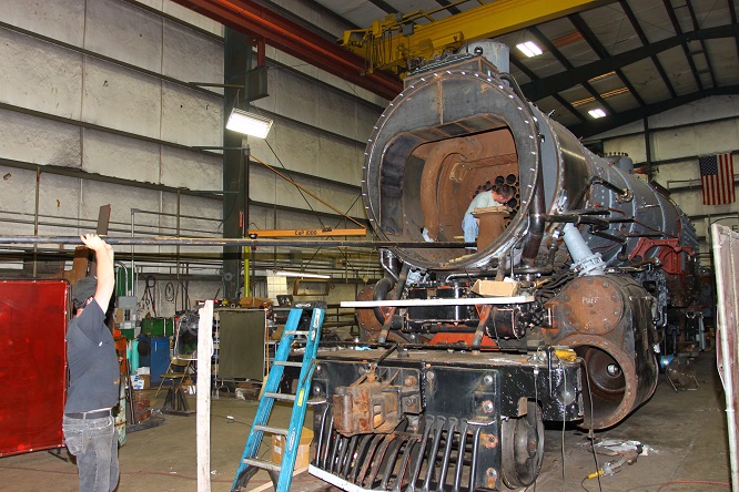

File comment: John Bohon installing copper ferrules into the rear tube sheet
Copper Ferrules Being Installed in the Rear Tube Sheet.jpg [ 135.74 KiB | Viewed 13038 times ]
File comment: Stoker Engine mounted with cold water pump located below.

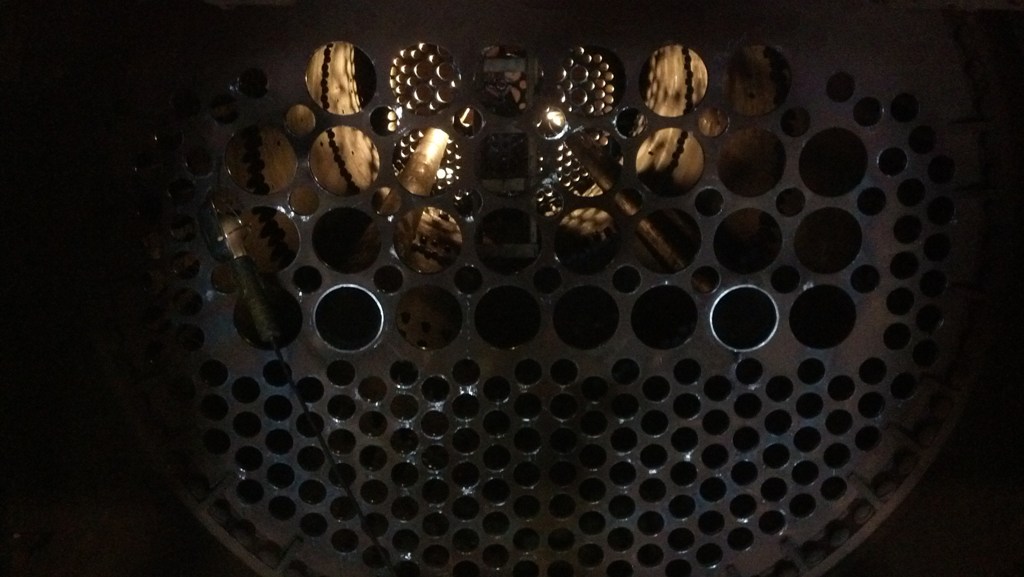

Great to see all the progress. I trust that that front flue sheet is the one put in in 1983/4 to replace the one that cracked in April 1981. From what I can remember it was unique in that the rivet ring was not pressed but rather the sheet and ring was fabricated. In the photo support triangles are clearly visible between the sheet and ring. Someone here would know if the ring was welded to the sheet before or after it was riveted in place.

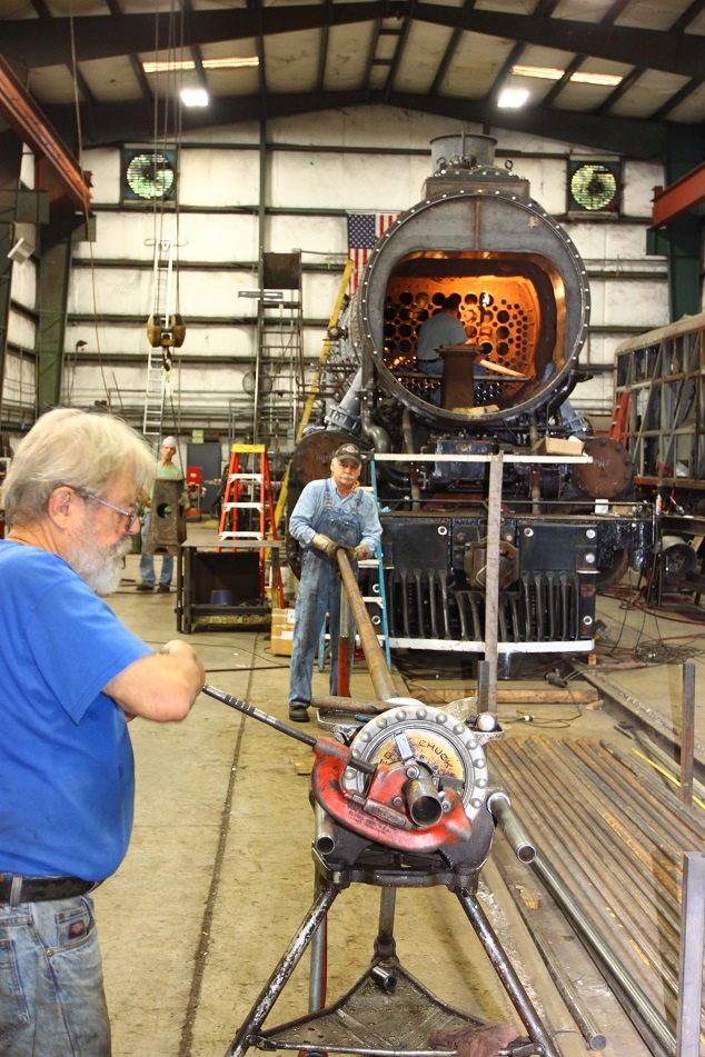

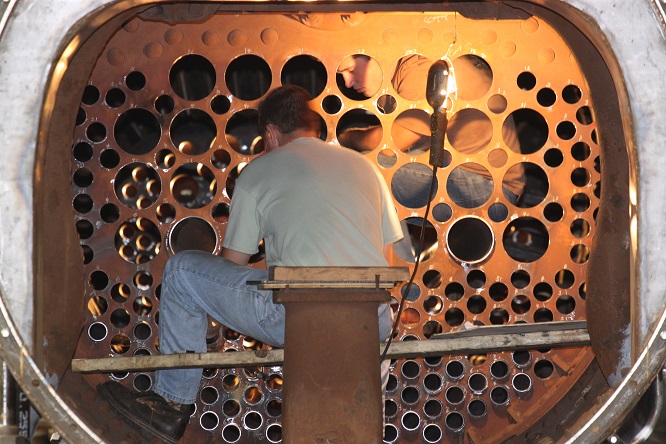

A few photos from 9/25:

Hadn't thought about it before but how do you get the tubes in that are behind the blast nozzle?

Doesn't that unbolt? Could those be in a good position to load through the firedoor?

Is the tube flexible enough that it could be fed into the boiler through a flue opening and then worked into place through its own holes? Not having put tubes in a boiler I'm not sure, but I'd suspect this is the case.

Usually the nozzle is removed to make all of this easier. I'm a little surprised that its back in. Also, the tubes are not very flexible at all but they certainly can be inserted through a flue hole then maneuvered into the right holes. But it's not really any more difficult to start it into the correct hole and just slide it all the way through. Someone has to be inside the boiler to help anyway. And no, the tubes are not usually inserted from the firebox end.

We never removed the blast pipe, superheater header, nor delivery pipes. With 213 holes to choose from, it was not a challenge to install the tubes behind the blast pipe. The tubes are cut to just barely project through the tube sheet so they can be inserted through an adjacent hole and "walked" over to the correct set of holes.
For those keeping score, the tube and flue rolling was completed this past Saturday. I completed the layout of the arch tubes also on Saturday so we are now ready to bend and install them.
