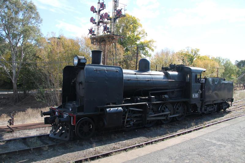

The locomotive shown below is a relatively small drivered Consolidation (Victoria Railways K190) operational at the Victoria Goldfields Railway in Maldon, Victoria, Australia. It is unusual in that it has Boxpok drivers, more commonly applied to large drivered, fast locomotives.
If Boxpok like drivers were desired, I would have assumed that they might have used Bulleid Firth Brown (BFB) wheels designed by Oliver Bulleid and Firth Brown were a later variation through a separate patent where a lighter wheel was obtained by using a strengthened rim. One of its major advantages over a spoked wheel is the more uniform support provided to the tyre.
The locomotive was built in Australia at Victoria Railways Newport shops. Presumably they could have used an Australian designed variant of the Boxpok idea, the SCOA-P wheel. SCOA-P wheels were developed in the late 1940s by the Steel Company of Australia Ltd (the P in the acronym standing for F. C. Paynter, who patented the design).

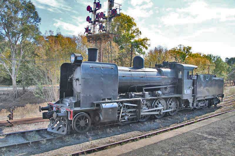

Here, have some free Photoshopping.....

I see no wisps of steam, so is K190 operable, or strictly a display engine? Did I miss that bit of info?

Definitely operable - it has been on loan to the Victorian Goldfields Railway from main line operator SteamRail Victoria, and is certified for main line operations.
Some of the VR A2 4-6-0 express passenger locos also had Boxpok drivers, and there were examples of both with a mix of spoked and Boxpok drivers.
Why? it looked better before...
Scot
Scot
ADM IV did the photoshopping I'm sure, to bring out some of the details. So, thanks for that. But in actuality, the engine sure looks good both ways!

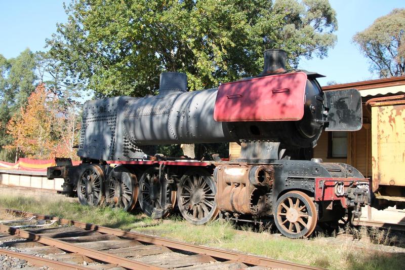

How cheerfully odd, that after having posted this oddity, steamlocomotive.info would acquire a photo of a locomotive in preservation with the SCOA-P wheels. See the photo below of Victoria Railway 2-8-0 No. J 516.

With the J Class and the SCOA-P wheels, there are 11 of this class remaining out of 60 built. 1 is currently operational, at the same railway that K190 was running at in the above pic and 2 are in the middle of overhauls. Both will hopefully be back in service in the next 12-24 months. J516 will be one of the next to be restored once one of the current overhauls is completed.
