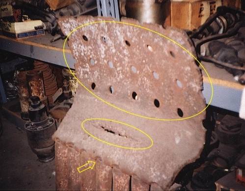

Button head crown bolts are not magic. They have a bigger head that effectively delays the dropping of an overheated crown sheet. Most locomotives probably had bare crown sheets at one time or another. Read anything on the narrow gage lines in Colorado and all sorts of tales come to light. Add some salt and divide by two and you still get some hairy occurrences. Button heads can be very useful in these situations.
In the situation where the water departs from the crown for an extended period of time and the crew is unaware of the situation, it is my opinion that button heads may make the situation worse simply by holding on longer and allowing a greater area of crown sheet to overheat. When it does let go - it goes for good. Unlike Gettysburg, where it appears that the sheet dropped earlier than it would have in a firebox in good condition. This early failure effectively contained the release to less-than-catastrophic. Evidenced by the tear noted in the photo, it was awfully close to complete failure.

PPS: I had a chunk of No.1278's crown sheet (removed with the permission of Sloan) during the investigation. It went missing c.fall 2003. I sure would like to have it back for "show & tell", no questions asked... JDC

"PPS: I had a chunk of No.1278's crown sheet (removed with the permission of Sloan) during the investigation."
JDC: It was such a pretty shade of blue, wasn't it?

The photo above is of J. David's piece. I have a piece of 844's crown sheet in my living room. I promise I didn't take yours, Dave...
