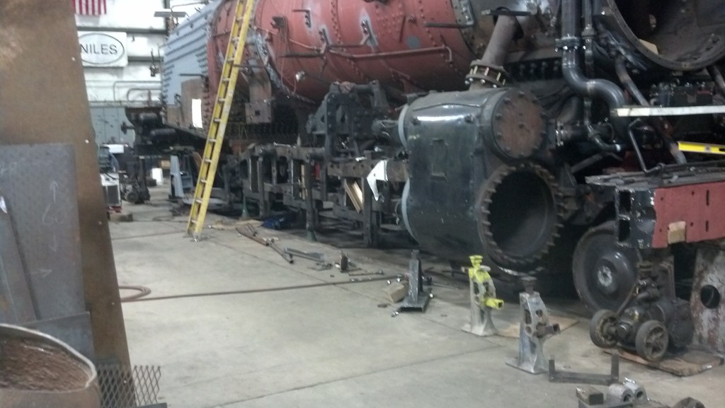

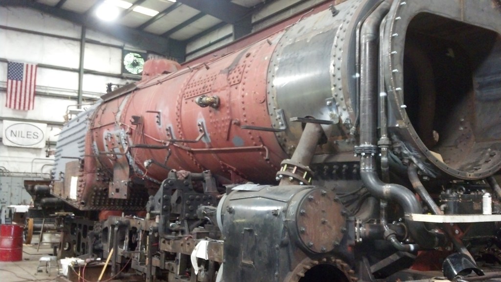

It's time for an update on 4501 overhaul progress. Lots has been accomplished over the past three months. I will attempt to hit the highlights for everyone.
Boiler - The new dry pipe end fitting was applied and the alignment of the dry pipe restored to the centerline of the boiler. The 1976 replacement of the dry pipe (installed in-place with 57" lengths of pipe) resulted in the steam dome end of the dry pipe being almost 2” off-center. This also explained an odd arrangement of the throttle linkage connection which we will also correct.
A new steam supply pipe has been added to provide steam to the Seller’s SR injector that will be mounted on the Engineer’s side. The existing turret has a limited steam supply due a single supply pipe. Original steam loads included two nine-inch air compressors, the blower, and two non-lifting injectors. Current steam loads include one 8-1/2 cross compound air compressor, a dynamo, stoker engine, hot water and cold water pumps, and the blower. Adding the injector to the same steam source would result in an overload and pressure drop to the auxiliaries. We know from photographs that other Ms Class locomotives got a second auxiliary dry pipe for the injector.
Coating of the boiler shell with Thurmalox has started with the backhead complete. All boiler brackets have been removed and Thuralox applied underneath them. This will be followed up with the application of Thurmalox to the remainder of the boiler shell.

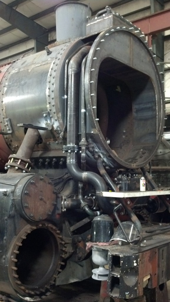

The new smokebox front has been completed, sent through the wheelabrator, and painted.
Some piping work has been completed on the feedwater heater system. Piping complete includes the exhaust steam lines to the heate, the pump suction from the heater is complete, the hot water discharge to the boiler, and the pump exhaust steam to the heater. In progress now is the heater vent line to the rail, the steam feed from the cab to the hot water pump, and the cold water supply from the cold water pump to the heater. A cushion check valve has been acquired and was installed for the hot water pump delivery.

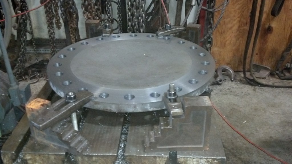

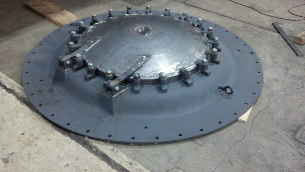

The new spherical steam dome cap arrived and has been machined. The flange of the original dome cap was machined to the point of being too thin. This necessitated either replacing the flange or replacing the entire dome cap. The cost of a new spherical and flanged dome cap was low to justify the complete replacement.

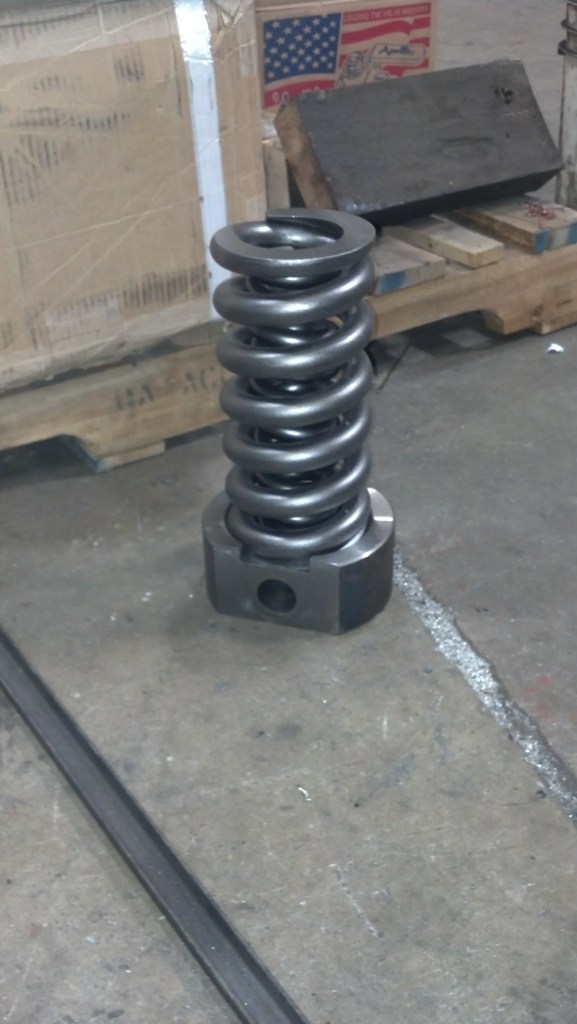

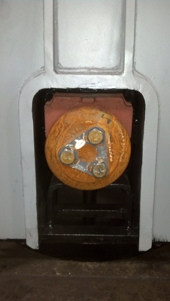

Machinery - All driving wheels and boxes are ready for installation. Fabrication of the oil cellars is complete and the Uncle Al Approved (UAL Approved) spring pad lubricators are on-hand. Pins and bushings for the spring rigging have been renewed. The lead truck has been reassembled but with the old wheelset. The supplier of the new roller bearing equipped wheelset for the lead truck failed to meet the original delivery date. New coil springs for the lead truck were obtained and I am very impressed with the quality (as opposed to our previous supplier - see the picture).

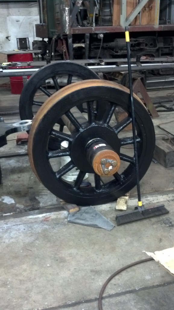

Rework of the trailing truck is completed and this includes - Conversion to a centering truck complete with a centering device, application of roller bearings, and installation of new tires.
Both the lead and trailing trucks are once again under the locomotive.
The original brake cylinders are being replaced with new ones and the locomotive will be converted to high friction composition brakes shoes.

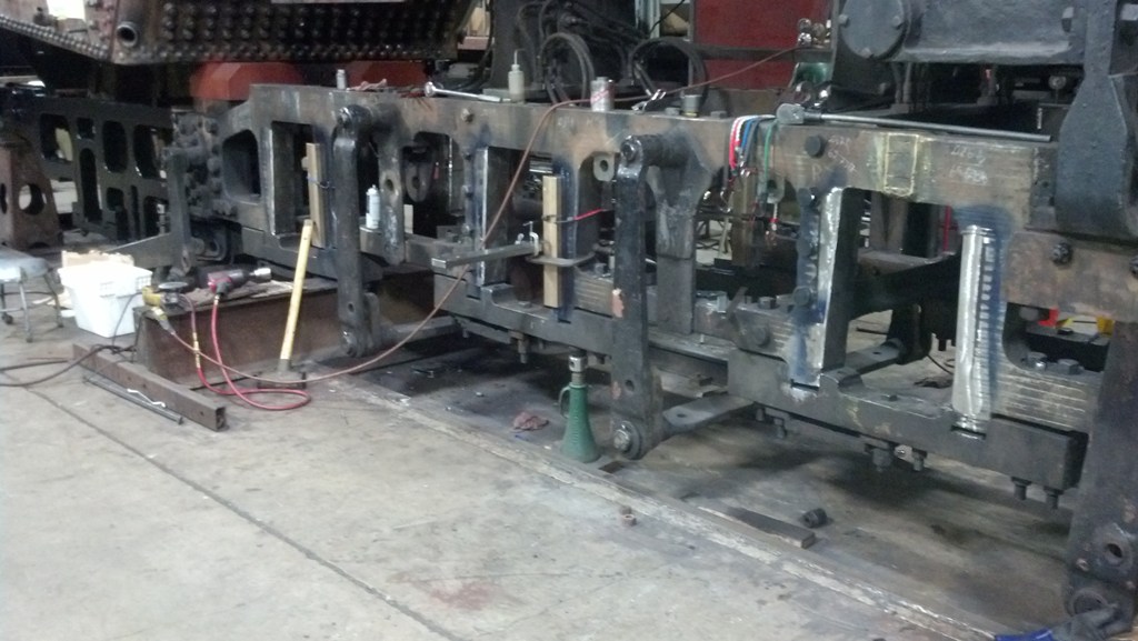

The frame pedestal faces are now dressed and machining of the shoes is complete. While the wedges are being machined, the spring rigging will be assembled in preparation for driver installation. Driving wheels should be back under the locomotive sometime in August.
Other - The coal bunker and cistern of the tender have been blast cleaned and painted with the appropriate coating. The Sellers SR injector is being prepped for installation. Finally, the Form 4 package is complete. Yay!

File comment: Trailing Truck Wheelset with Roller Bearings

File comment: Close of the roller bearing on the trailing truck
Close Up of Roller Bearing Wheelset installed in Trailing Truck.jpg [ 78.64 KiB | Viewed 13180 times ]
