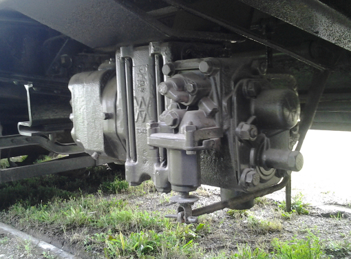

Could someone please help me to identify the make and model of this control valve? There are no identification plates on it. It's on a WWII Pullman Troop Sleeper. Thanks in advance.

AB-1B. AB service, AB Emergency, 1B filling piece.
