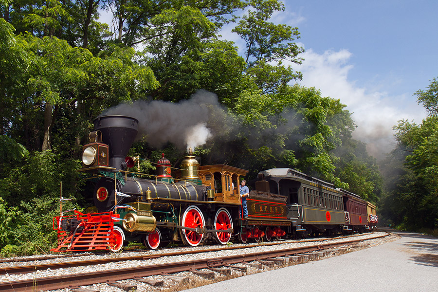

I took a long ride to New Freedom, PA to catch what was
advertised as the "Grand Opening" of Steam Into History
featuring the newly built 4-4-0 #17. "The York" was built
by Kloke. Despite being the Grand Opening, the engine has
been running since early June and performed great on the
first of 3 runs scheduled this Saturday, June 22nd.
What an amazing operation - one you could easily, well,
at least pause to just stare and marvel while leaving a
camera simply hanging by a neck /shoulder strap. Just
looking at the way the engine was built and designed to
operate brings you way back in time, despite the Toyota
Tercel parked in view. Lot's of simple shapes bent and
formed as needed - you could visualize how these great
machines came to be so long ago.

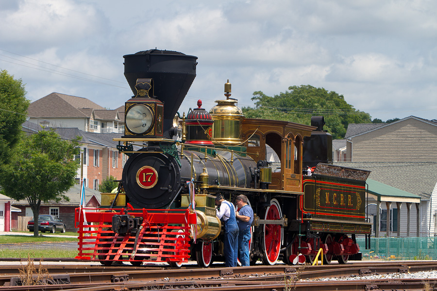

Unfortunately, some mechanical issues (reverser?) came
up which were not able to be immediately resolved, though
hardy attempts were made.
Wish the staff and crew the best of luck (I think they'll
be good to go), but a pat on the back and hats off to them.
You could tell the love they have for this train and
operation and the difficulty in dealing with the day's
misfortune.
FYI - the steam engine pulls the coaches backward (a
misleading chase as the return trip runs MUCH faster).
When it reaches Hanover Junction, they uncouple the
steam engine ahead of a tiny spur large enough for the
engine to fit. A diesel moves the coaches back a train
length and the steam pulls back onto the main and then
backs up to couple. At New Freedom, there is a passing
siding. What this means is there is no way to sub the
diesel as there is no way to get it on the point - though,
I'm not sure why they were not able to run coach first
with two way radios for "vision".

It's difficult to maintain inside Stephenson valve gear without a pit. The description of metal against metal.....sounds like either something got loose and went where it shouldn't go, maybe fouling another piece, or perhaps a lubrication failure with repercussions.....all reasons why it is critical to be able to get under her and assure the intergrity of all the connections between parts every operating day.

Indeed, one man was temporarily lying on the ties when trying to work on the eccentrics. Not too comfortable, taken into account that similar work might be done more frequently. They hired a local contractor for what looked to be an approach to lift the left-hand driving wheel.
Probably they should have someone come from Strasburg?
