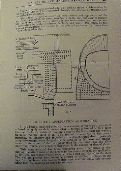

Dave wrote:
The front few inches of crown sheet was cut out and new metal welded in. This required the top few rows of tubes to be removed for access, then new tubes installed again. At least, that's what was done on my watch.....not sure if Jason had any repairs to make or if Phil did any heavy boiler work before sending it on.
dave
Gary and I replaced the doorsheet and rear fluesheet will with ones of a flanged design, the door hole opening was reduced in size to that of something more appropriate (if you recall it was huge and square), front fluesheet was replaced to accommodate application of a proper tube pattern, all doorsheet/backhead and throatsheet bolts were replaced with larger to accommodate the higher loading resulting from a larger than standard bolt spacing, all bolts in sidesheets were replaced with larger for the same reason and transverse stay rods were installed (as is done on european locomotives which have wagon top boxes with vertical crown stays).
All of this work was done to make the boiler legal under FRA regs as was dictated by the results of form 4 calcs I performed.
We were also in process of superheating the locomotive (already had all material on hand but the unit runs) only lacking about $50,000 worth of work to complete the process.
The only work performed after I left (as a result of Railstar losing the operating rights) was absolutely misguided. Almost three times the cost of finishing the superheat conversion was spent to put yet another set of tube sheets in with a non locomotive type tube pattern. In fact, the pattern in it now is actually referenced in several texts (from the teens and 20's) as an old design that is absolutely not to be used as it shortens tube life due to overheating/burning of the material. It's all a shame, that locomotive could have really performed!
Dave, there is no one employed at that operation capable of doing boiler work.

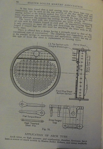

Robert Yuill wrote:
Jason, I do not know of square cornered throat sheets- inside or outside. I'd like a citation to the info you saw.
Robert Yuill
Sir Yuill!
I do not remember what year these are from..... and I am surprised they are still hiding in my camera but this is the reference.
Cheers, Jason
