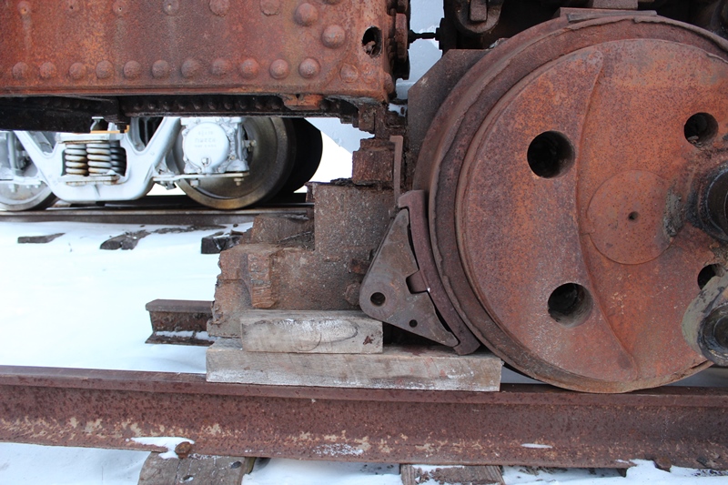

Jones & Laughlin 58, our 23" gauge Porter 0-4-0T, was never equipped with engine brakes and none of the cars it handled had brakes either. I suppose braking was handled with the johnson bar or they just banged around a lot. We are planning to add a rudimentary steam jam brake to the locomotive which will use two brake shoes pushing against the rear drivers.
I am trying to figure out what the braking force should be for cast iron locomotive brake shoes on standard gauge locomotives and how it is determined. Is there one value that is desired, or is there a formula that takes into account the weight of the locomotive in caclulating the braking force?
If I can understand the engineering behind locomotive braking, I can do the math and figure out the braking force that I will need.
The photo is of a brake shoe and holder mocked up in place. To the left you can see where we are missing the entire rear end of the locomotive, which will be rebuilt. The brake system will consist of two brake hangers tied to a crosswise brake beam and pushed from the middle by a cylinder placed between the frame.

Normally you would want 100% of the weight of the locomotive as the force on the brake shoes, gross. Since the plan is to brake only half of the axles, 50% gross would be used. Applying the force at the brake beam will reduce rigging losses, so the gross and net will be nearly the same, so maybe a 35% force will be more appropriate. This is based on cast iron shoes. There are other considerations. I would recommend you get a copy of the book Engineering and Design of Railway Brake Systems, put out by the Air brake Association.

Thank you David. I am going to defer spending $75 for the book for now, but based upon your 35% number that gives me 32,000 lbs. of braking force , exactly what an 8" steam cylinder at 160 psi would provide.

I would have some concern maintaining that high of a braking ratio on a single set of wheels using the short length of brake shoe shown in the photo. Also would there not be some concern with wear of the tread and changing wheel tape sizes on rod connected drivers. Would it be possible to install the brakes to operate between the drivers with a shoe on each wheel using a wedge or cam mechanism ala the early American type locomotive steam jam brakes.

Mike, I understand your concerns about premature wear of one set of drivers with brakes on only one axle. The frame is SOLID and there are 4" slabs that sticks out between the drivers too. Of course that is what makes this locomotive unique, but at the same time it complicates what otherwise would be simple matters. It may be possible to add two additional shoes in front of the front drivers. I have to be very careful to do it in a way that preserves as much clearance as possible between the rigging and the top of the rail.
Kelly, on that 60% figure, is that number spread out amongst however many shoes are on the locomotive? In my case, with a 93,000 lb. locomotive, 60% would be 55,800 lbs. and spread out amongst four shoes would be 13,950 lbs. force per shoe, or 27,900 lbs. if I have to stay with just two shoes.
