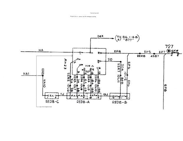

The is so you can standard AAR which is to 27 M. U. so all GE and EMD , And the F7 did not a limit 4 the train.
This rewire in engineer space at take Brake Control and Selecter Switch.
This Load Resistor need a wire To/From it.
The leads for 3 M. U. that label FB and FC a gone alone relay an method for 3 M. U. connect.
Has a way get a Standard AAR from with alone 27 M. U. a can to GE and EMD I will be grateful.
Owen S. Paulsen
o.paulsen@sbcglobal.net
File comment: This is from a GP-9 Engineer Stand take at 24 to 27 M. U. on 24 pin. The other half is on second e-mail. The F7 need a wiring to compatible with all lead.
Last edited by Owen S. Paulsen on Sun Sep 15, 2013 10:49 pm, edited 1 time in total.

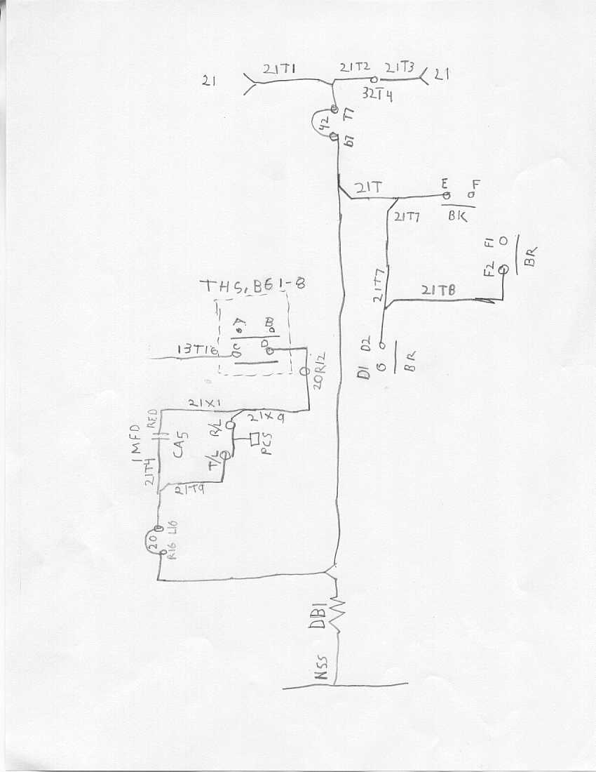

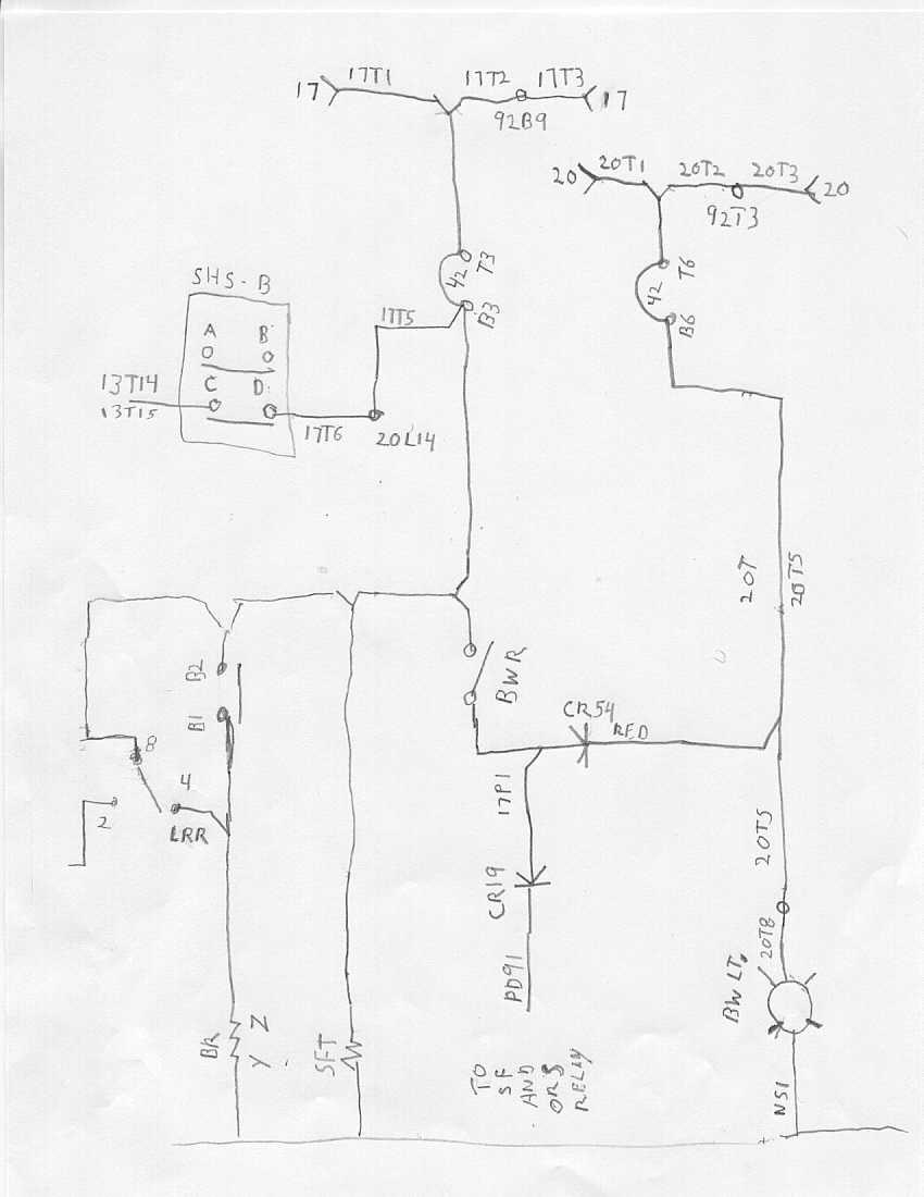

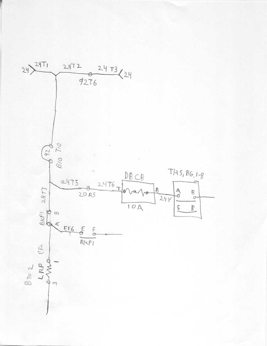

The http://gelwood.railfan.net/manual/f7chart6a.gif and f7chart6b.gif DONT SO ANY The unit can do want I need.
In the Engineer Stand in a do it the right hardward for and next to is a 1 to 4 Switch to Select 1 the 4 on FB an FC on EMD type for trail unit of 3 EMD the has same 3 M. U.
like a early GP-9 ,GP-7 which be tie the F7A.
The problem that 3 M. U. was EMD design only at cover first 4 unit.
The AAR Standard put wiring in 27 M. U.
This allow the rail to have 6-8 loco a EMD an GE mix.
The problem in that old (before AAR) would not go a GP-9 that has an 27 M. U.
The GP-9 as 8 level for run 1-8 an amount is determine by 27 M. U.
The F7 in a new for Engineer Stand.
Owen Paulsen
File comment: This is part on 24 M.U. is the 1/2 on ckt.
GP-9
File comment: This GP-9 a should compatible with a F7
File comment: This is a GP-9 a correct for the GP-9. What I need to compatible with this.
