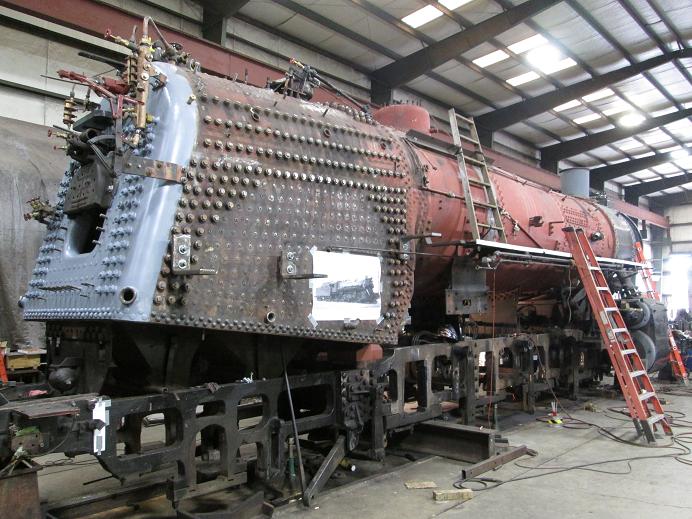

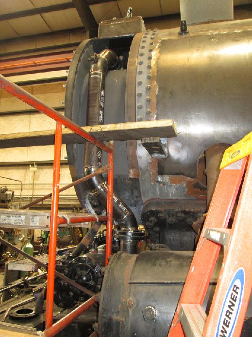

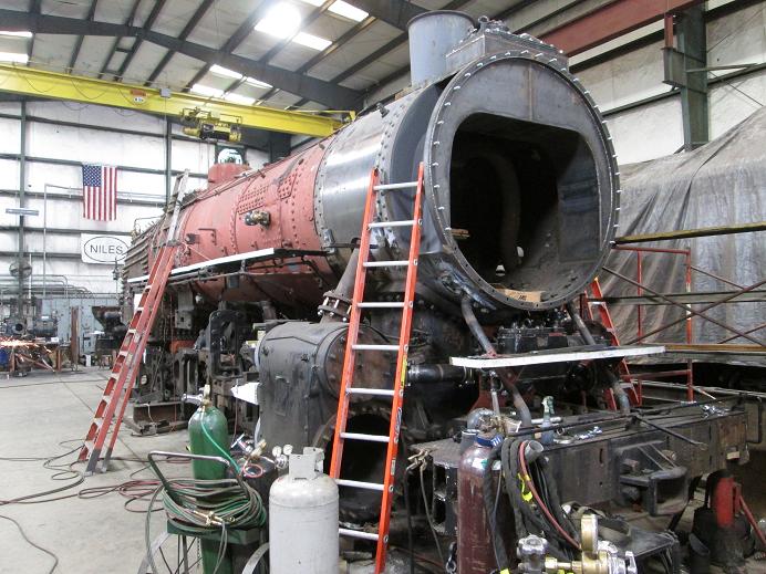

Here are a few "visual updates" from today.

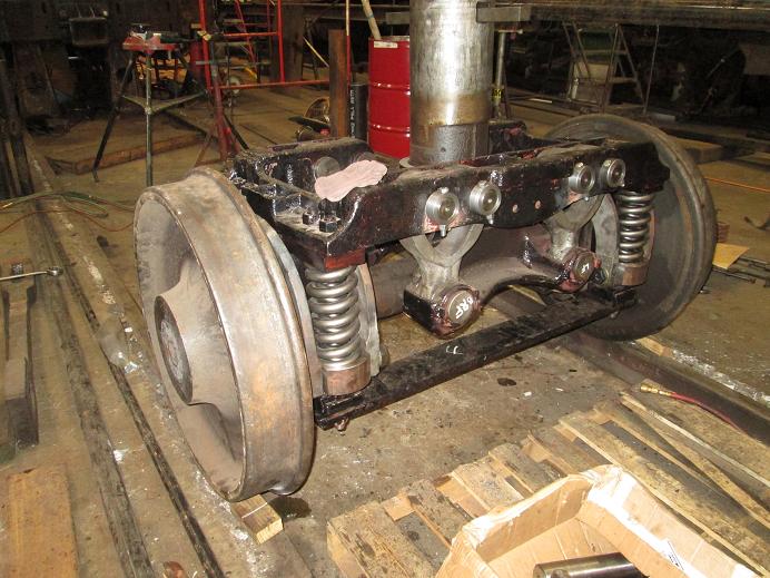

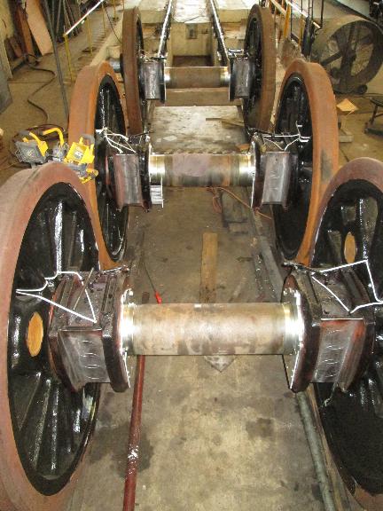

...and a few more.

Beautiful pictures, guys...but what's with the picture on the firebox? Incentive?
Something like that I guess...
