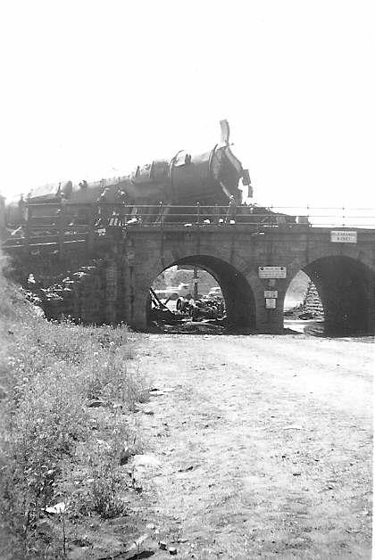

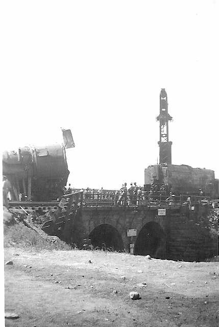

Excellent stuff, never seen a report on this, did pick up these pictures in a local antique store though.
