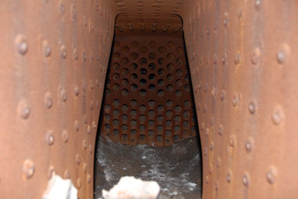

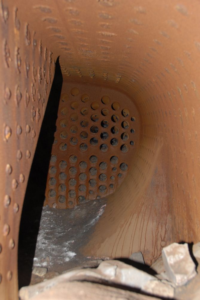

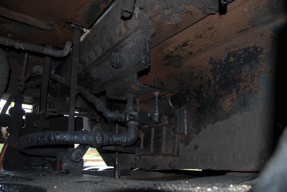

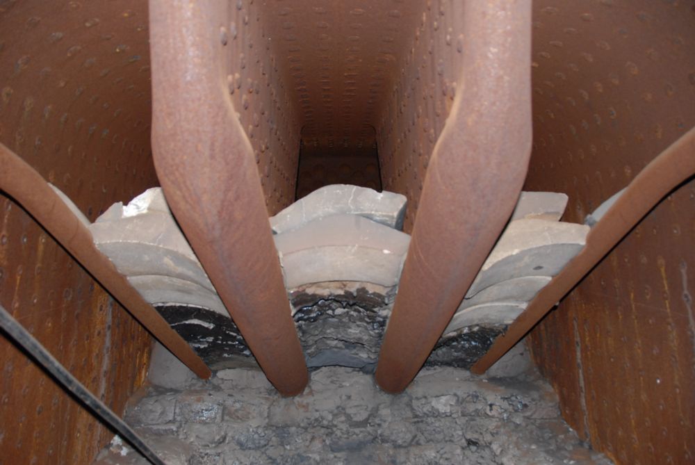

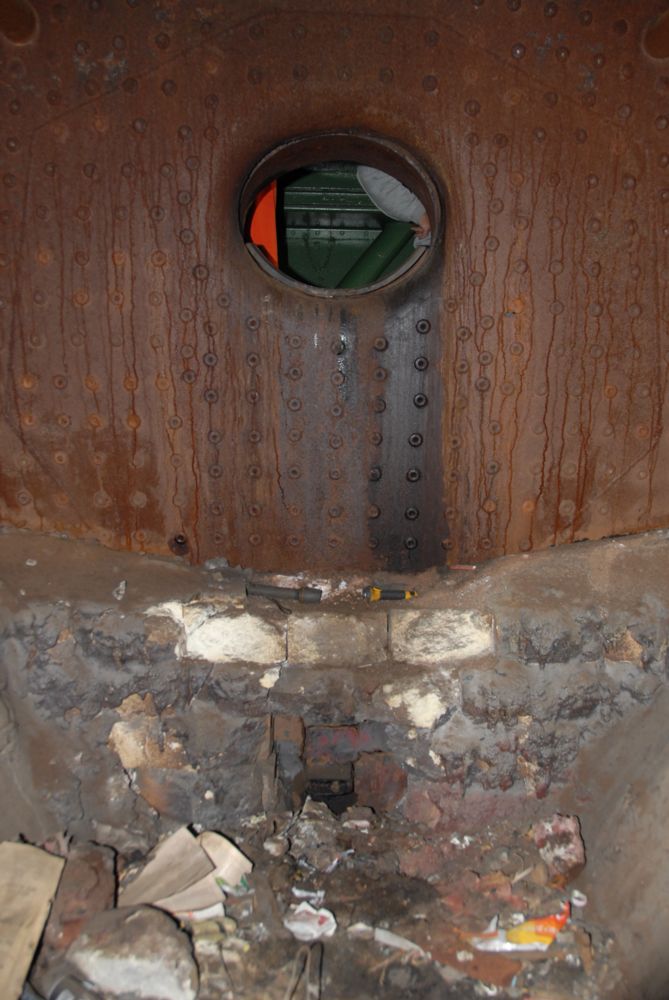

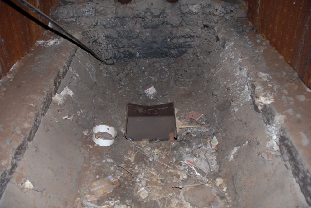

Views of 6077's firebox, showing the arch tubes and thermic syphons, brick arch and damper.

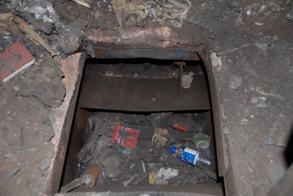

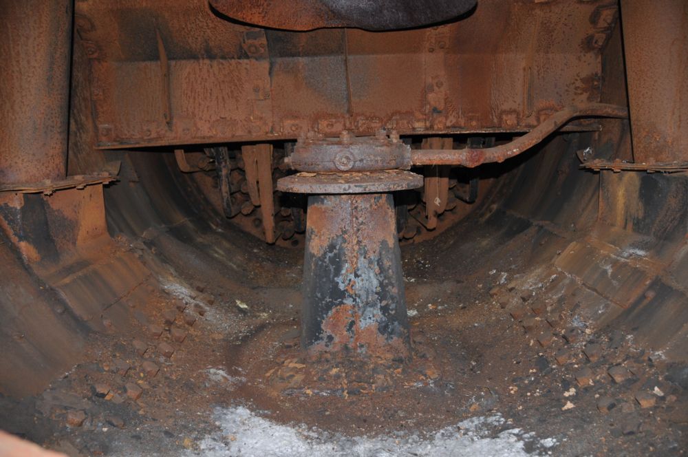

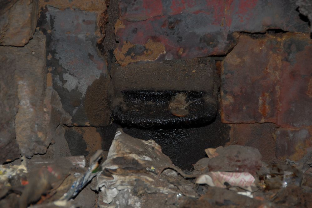

View of the burner in 6077's firebox. Note the large section of the back of the boiler that was replaced when the CNR converted her to burn oil, reducing the size of the firedoor opening after removing the HT Stoker.

OK, superheaters shrouded - possibly with a superheater damper as original equipment?
So, it looks like there's very little air opening around the burner, primary draft coming in at the forward end of the firepan - maybe in the last third(?) and probably some form of secondary draft through a vent in the firedoor - am i about right here?
Thanks - great photos.
dave

Looking at the back of the burner, it seems like there is some sort of swinging door, operated by a lever that runs up into the cab.

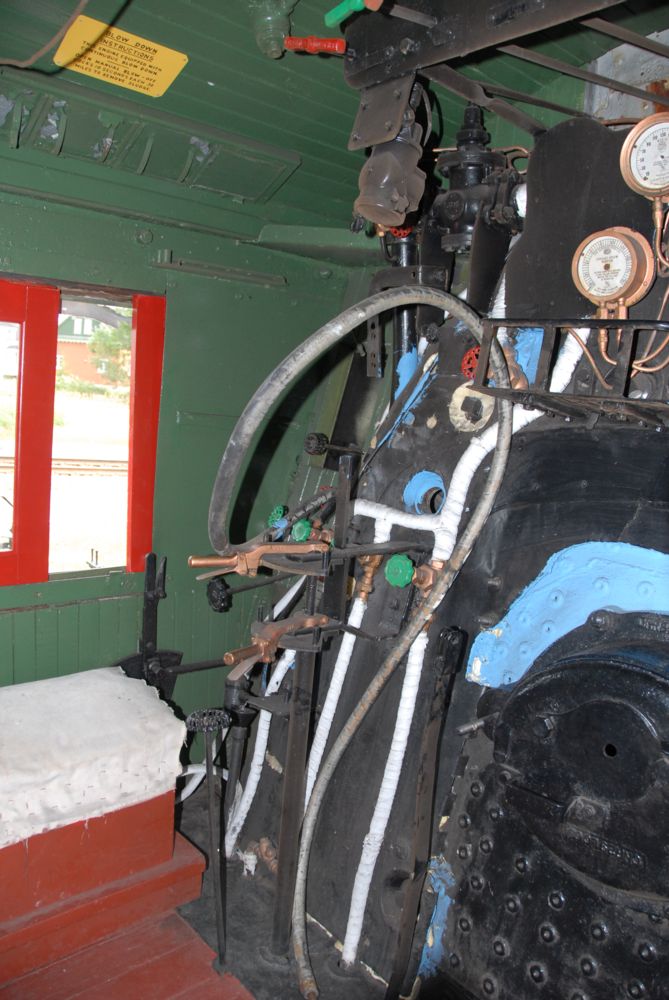

Here's a shot of the fireman's controls. You can see the two levers used for controlling the firebox, the top appears to control fuel flow, while the bottom would control the damper. The lever that runs to the door on the back of the burner is just to the right. And one of those steam valves would control the steam supply to the burner.
 Post subject: Re: Canadian oil firing practice
PostPosted: Mon May 20, 2013 7:39 pm
Posts: 1119
Location: Warszawa, Polska
A good question would be how would that damper on the back of the burner be used and what was its purpose.
Did it allow air into the firebox, or was it related to maintenance, or was it used when lighting the fire? Would it be open all the time; could the size of the opening be controlled, or was it a matter of either open or closed?
