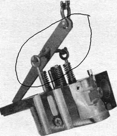

Owen, I think I understand what you're looking for. Let me know if I'm understanding you correctly.
What you're looking for is this tool which is used for removing the head & cylinder from an Alco 244. http://www.railswap.org has the tool, but it's missing some parts. You are looking for the dimensions of those missing parts. The missing parts are circled in the picture.
One part is the large bar which is supported by the hook at the top. The other missing parts are the eye bolts, and you're asking what the thread size on those eyebolts is.
If one of us has the drawings with the dimensions of those missing parts, or has the actual parts, you'd like them to email you.
Is that accurate?

Owen,
I think the tool you describe will only hold the head at 45 degrees.
It will not (by itself) lift the head away from the block at 45 degrees.
Your crane or lift will have to move the head away at 45 degrees.
The studs will help guide it. I am assuming the engine block has studs to hold the head down. If not then you can just lift "straight up".
If possible you could also install a "low" and a "high" eyebolt (if tapped holes permit) and then use two "come-alongs" (cable winches) (one long one to the low eyebolt, one shorter one to the high eyebolt) to support the head at 45 degrees.
Looks like you have most of the details for a cylinder liner puller.
Hope this helps.

Owen,
I mentioned 45 degrees, that was just an example, looks like the angle is more like 30 degrees away from horizontal. But with two cable winches you can adjust to any angle you need.

Someone Reach out to Howard P., I know the RMNE has a head lifter for a 244 that I believe was fabricated I could be wrong, I am pretty sure it was fabricated it May be Cheaper to have one made than trying to get a complete tool

I personally made a use various parts 20 years ago but a doo-rite clear up the shop a he did not done to museum at toss part in trash.
I need make it new set on lathe,drill press and other tool at house.
The re-did the whole interchange <ALCo 244 tools for remove the cylinder an head> so you can see want the need?
