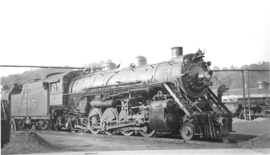

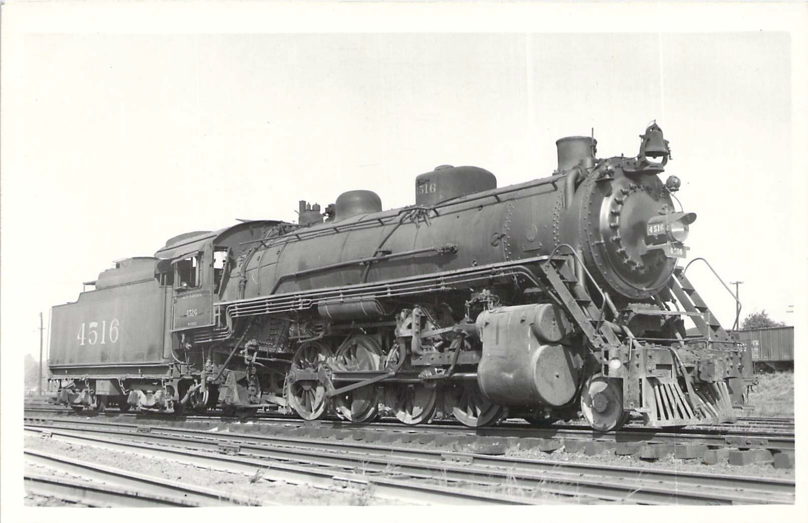

Btw, for those of you who are curios to how the Southern mikado locomotives looked with Worthington feed water heaters, here are two photos.
