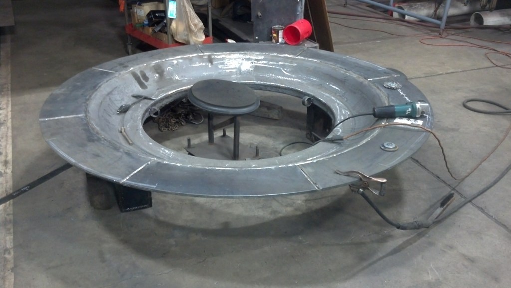

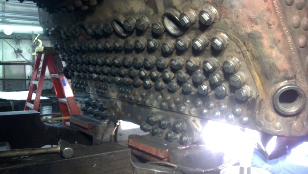

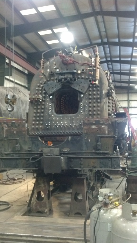

I guess it's time to provide another update on the 4501 rebuild progress. Let's start with the boiler -

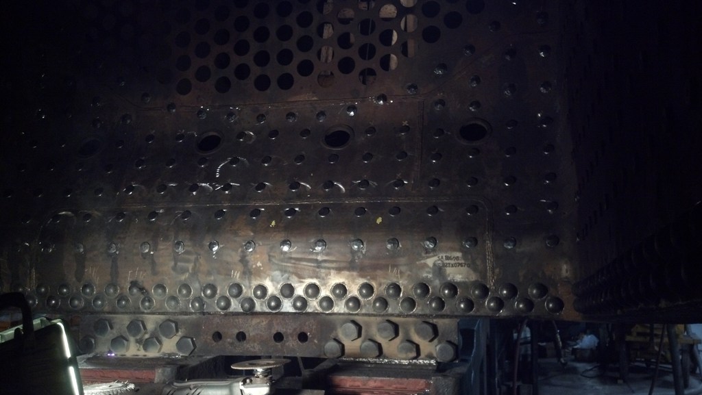

The firebox work is complete. She's now had 100% of the staybolts and mud ring rivets replaced, around 97% of the firebox sheets renewed (two small areas under the rear tube that were renewed in 1984 were left intact), the backhead replaced, a flush patch installed in the right side exterior side sheet, the exterior throat sheet renewed, and a flush patch put in the dome course to replace a forge weld. All radiography has been successfully completed.

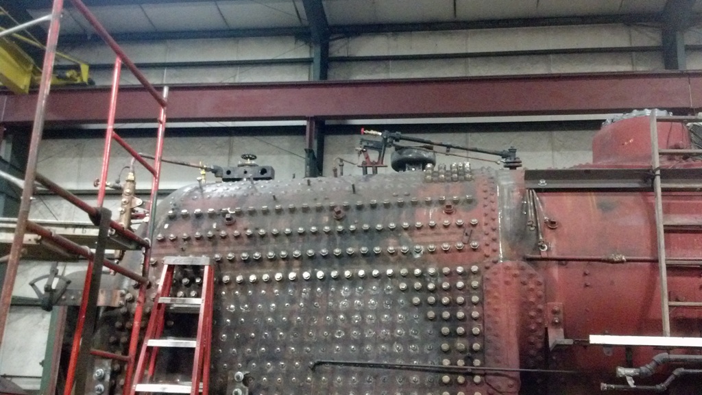

All the boiler studs and boiler fittings are applied. The tubes and flues will not be installed until she's back on her wheels. The fluorogold material arrived and was attached to the furnace bearers so the furnace bearers are now back in place. Finally, the new smokebox front is being fabricated using the same centerpiece pattern as 630 and 765.

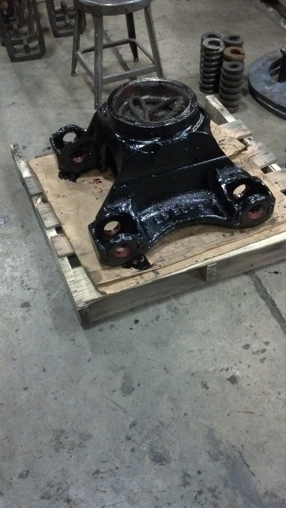

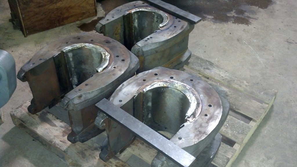

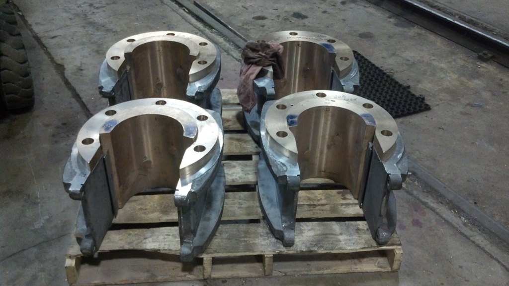

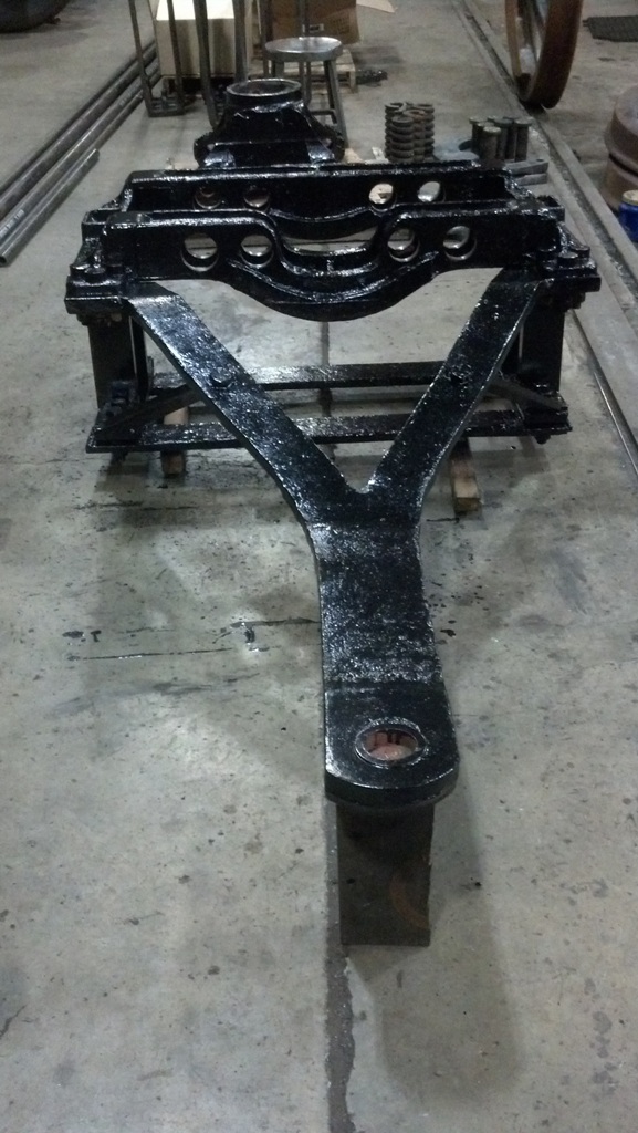

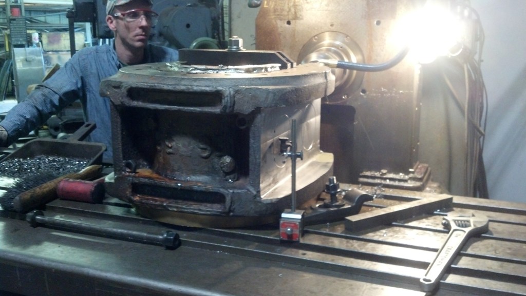

Machinery work is in full swing. All the spring rigging is sitting on the shop floor. We found the front equalizer was frozen solid at the pivot pin which made it difficult to remove. The engine truck is ready for assembly once pins and bushes are returned from the heat treater. The driving boxes are coming along quite well. Hub liners are applied, babbiting installed, and final machining is underway. The shoes and wedges are being cast and should arrive just in time for machining.

File comment: Completed Exterior Throat Sheet
File comment: Completed Interior Throat Sheet
File comment: New Smokebox Front being fabricated

File comment: Top of boiler showing low water alarm, turret, and new safety valve manifold

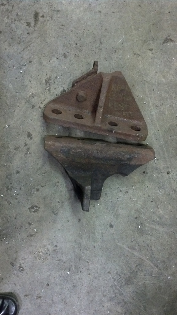

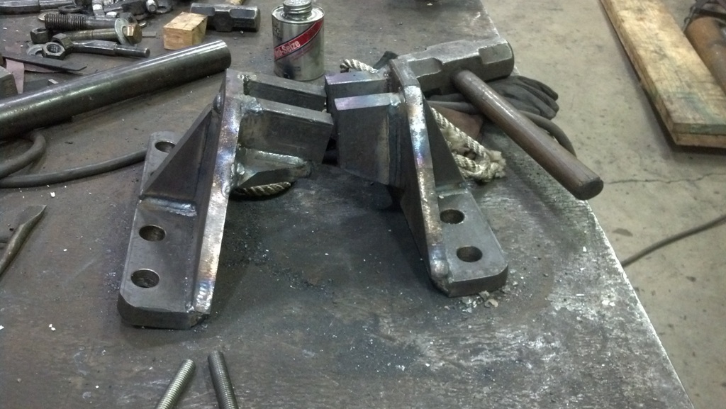

File comment: Old Center Rest Supports
File comment: New Center Rest Supports

File comment: Rear of Boiler
File comment: Lead Truck Frame
File comment: Lead truck swing bolster

File comment: Driving boxes after installation of hub liners
File comment: Driving Boxes with babbit placed
File comment: Driving Boxes being machined

As always, interesting information. In the other thread, someone pointed out that while on the K&T and in early excursion service, she had a lot more flexible staybolts on the side sheets. These were "lost" at some point, with rigid bolts taking their place.
Do you know when this was done? Were the additional flexible bolts applied by Southern in service or the K&T?

We first applied fluorogold on 630's furnace bearers and it has done well. No further lubrication required.
The exterior side sheets were replaced in the 1970's to remove all those flexible bolts. We were ablXe to see the welds real well on the inside once the firebox was out.
The information regarding the lettering of 4501 in Stearns is not fully correct. A team of TVRM personnel were involved in that effort including Bob Soule and Grady Ragan.
The cylinders will remain at their present bore which is 26-5/8". The diameter of the cylinders was reduced in 1968 from 27" to 26". Cylinder borings since then have increased the diameter. In 1996, the last boring was performed. The pistons were modified then to accept T-type sectional rings.
