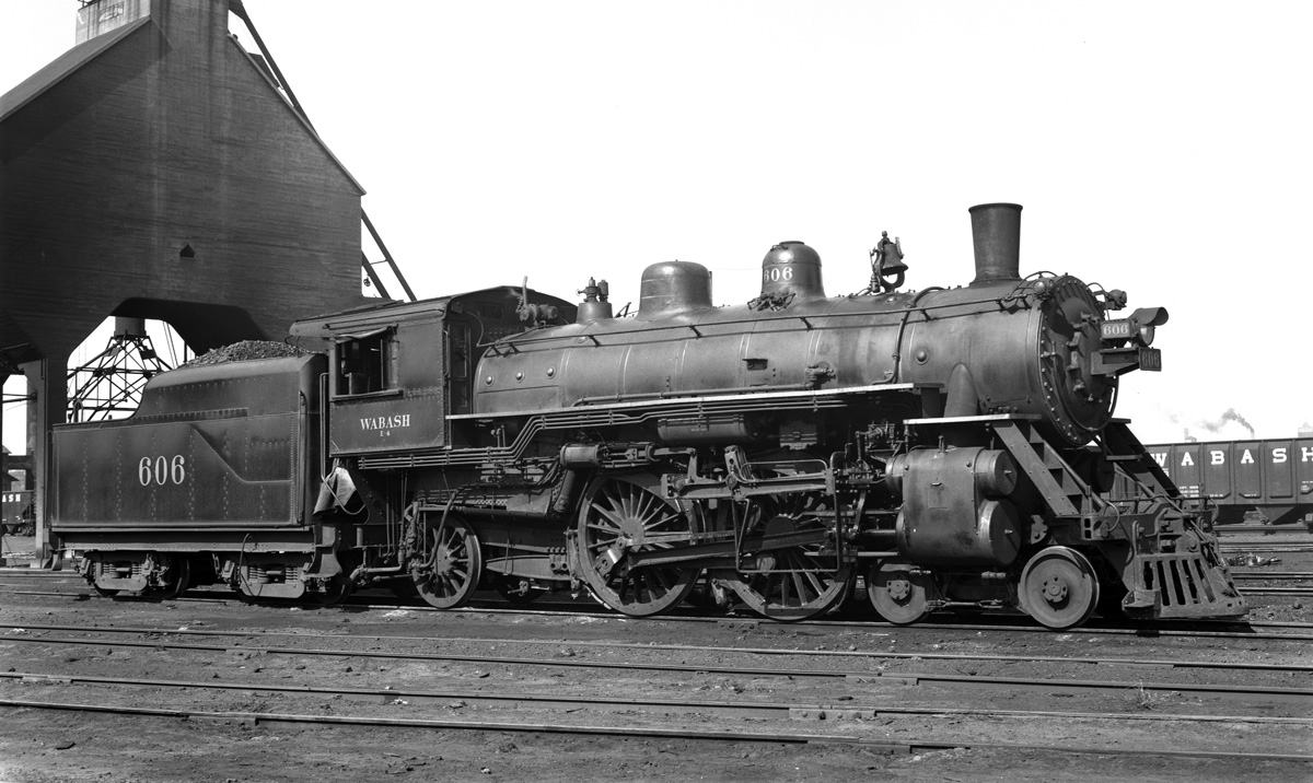

I was scanning some negatives for the "auction site" and noticed a couple of the Wabash 4-4-2s equipped with Locomotive Valve Pilot. Kind of surprised me.

Awesome picture! Thanks for posting! I couldn't find any information on the Wabash using Valve Pilots, and I was really puzzled by that. The Wabash had the perfect flat track profile coupled with a corporate obsession with "faster" that would make it a natural Valve Pilot customer. It is quite rare to see a Valve Pilot on something as small as a 4-4-2, although not entirely surprising considering the Wabash's full throttle proclivities. I'm wondering if the Valve Pilot addition was part of a comprehensive rebuilt? Cast pilot, drop coupler, modern nonlifting injector, Alco Type G power reverse, tender and Okadee cylinder cocks are definitely new. The lead truck and mechanical lubricator are likely retrofits as well. The valve gear also looks more modern than the locomotive. Specifically, the design of the eccentric crank and link as well as the union link connection at the wrist pin seem to be more modern practice, although there are so many detail variations in Walschaerts that I may very well be wrong. Overall, a really gorgeous engine, but then its hard to make an Atlantic unattractive. Any idea what kind of service this engine was used in? Thanks again!

Wow, not only does it have a Valve Pilot, it has power reverse, and a cast drop coupler pilot. Quite modern for a 4-4-2.

Just took another look at this gorgeous photo, and realized how many details I'd missed, including that cast pilot.
Certainly a very thorough rebuilding--the original locomotives in class E-4 dated to 1904:

I wonder what inspired Wabash management to rebuild these engines into this form when they were 20 years old. Granted, the Wabash is a flat road, but it still seems a little unusual for the company to put that kind of work and money into something that light at that date.

Also from Richard Leonard, the same No. 606, with Valve Pilot, lagged smokebox, but before getting the cast pilot:
http://www.railarchive.net/randomsteam/wab606.htm

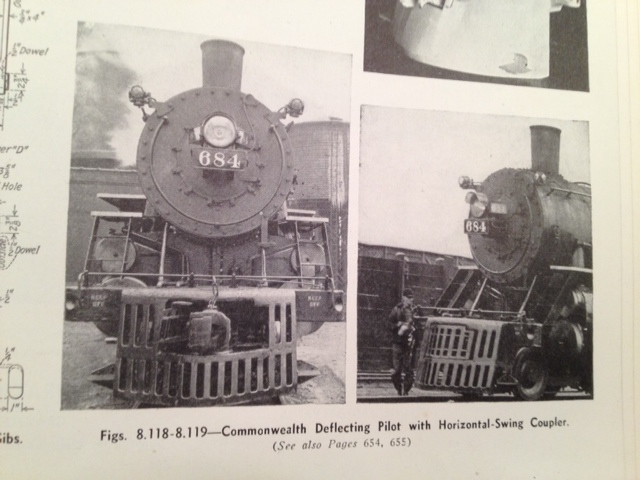

Speaking of modernized locomotive power, after this thread appeared, I noticed these two images in both my 1941 and 1947 editions of The Locomotive Cyclopedia. Pictured is the layout from the 1947 edition.
It appears that the Wabash liked to modernize older steam power, in this case a 2-6-2 that the Wabash rebuilt into a 4-6-2.
I find it a bit ironic that both the 4-4-2 at the start of this thread and this old 4-6-2 ended up with pilots we normally associate with modern steam, such as NYC 4-6-4s or UP 4-8-8-4s.
