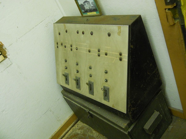

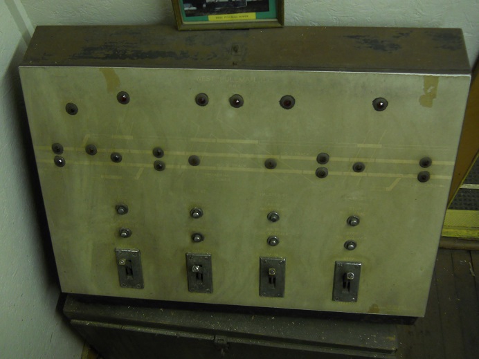

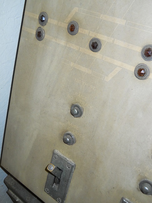

Looking for a little assistance. Here are a couple of photos of a control panel that was donated to HVRM some years ago. The panel is labelled as being from West Pullman, Illinois. There are four streets on the diagram; 118th, 119th 120th and Halsted Street. The markings are etched onto the face of the panel, but hard to read. I am wondering if these were originally painted (there is no evidence of paints in these grooves) or something, that would have made them more visible to the operator. The control panel was made by Western Railway Signal and I am not sure or the material on the face.
There is a second question. There was a Pennsy tower at West Pullman, Illinois controlling the crosssing of the railroads old Panhandle line between Logansport, Indiana and Chicago, with the Illinois Central's electrified branch line to Blue Island, Illinois. A photo of that tower is attached to the control panel, but was probably added by the person who donated the panel. The problem is that the four streets mentioned above are quite a ways away from the tower (which was located near Union Avenue, about two blocks east of Halsted). The impression we have always had at HVRM, is that this gate control panel was in the tower itself, but I am now wondering if it might have been in a separate watchman's shanty or tower nearer the crossing of these four streets. In fact, the face of the panel shows an "aerial tower" located near the crossing of 119th and Halsted streets. I was able to find a schematic of West Pullman tower and there is no indication of any gate control panel on it, although even if it was in the tower, it probably would not have been on the schematic anyway.
Any help, or ideas, would be appreciated.

Les,
In the few photos of similar equipment, usually I have seen them Black with White traces. With yours, I wouldn't doubt if you removed one of the 4 switches you will find that the panel was black, and the paint was either cleaned off or just oxidized off.
Another possibility would be that the background was polished before the markings were etched or sandblasted. Not sure how the contrast between polish and the blast/etch would be.
Regards,
Rich C.

Les:
I have seen a bunch of those panels that were made by Western RR Supply and they all look like that ! It appears that they applied some kind of clear coat and over time they have all turned to grey.
We have the one from WALBRIDGE TOWER at Marion, and there is one spot under that top layer that is a nice BROWN in color. We cleaned the panel with acetone, but it's still nice and grey.
The PRR had lots of those model boards.
Kevin K
 Post subject: Re: Gate control panel
PostPosted: Mon Apr 08, 2013 6:12 pm
Posts: 512
Les;
That material looks like either Bakelite or Micarta, both early thermosetting plastics. They were widely used as electrical insulators and as radio cases, toys, billiard balls and even plates and cups.
They started out a nice brown color (like old distributor caps) and then oxidixed and turned dull gray.
I have had success polishing them up with a buffing wheel and some rouge. For electrical applications (distributor caps and rotors) I have soaked them in WD-40 (tm) to seal any surface cracks. They work fine after that.
I think the lines and lettering were machined into the surface and not polished. Rough machined Bakelite has a white/gray look to it.
Bakelite is named after it's inventor and is recognized as the first synthetic plastic.
Cheers, Kevin.
PostPosted: Sat Apr 13, 2013 4:52 pm
Posts: 6487
crij wrote:
Les,
Regards,
Rich C.
Rich -
Managed to get a little time in at the museum this morning and I unscrewed the backing for one of the switches as you suggested. There is definitely a different color under there, and it's probably the original color of the entire face of the panel. Whether it was dark brown or black I couldn't tell for sure as the various coffee drippings, rain water, and other type of spillings through the years, had also stained that part of the panel. However, it was definitely of a darker color.
The "etching" for the lettering and street outlines is not very deep. If you look from the side of the panel face where it "runs off the end", it is hard to even see an etching there at all. Anyway, the bottom line I guess is that there is probably nothing I can do to make the panel more readable for visitors and we'll just have to live with the way it now appears.
Thanks again to all who offered their comments.

Posts: 6487
One thing I forgot to mention is that WRRS had the terminology SIG-NA-TROL down in the lower right corner of the panel.
