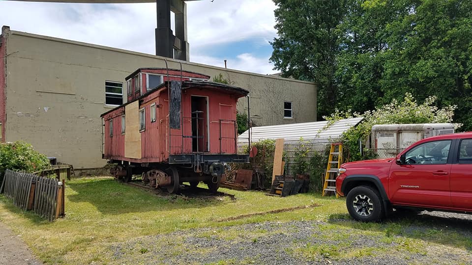

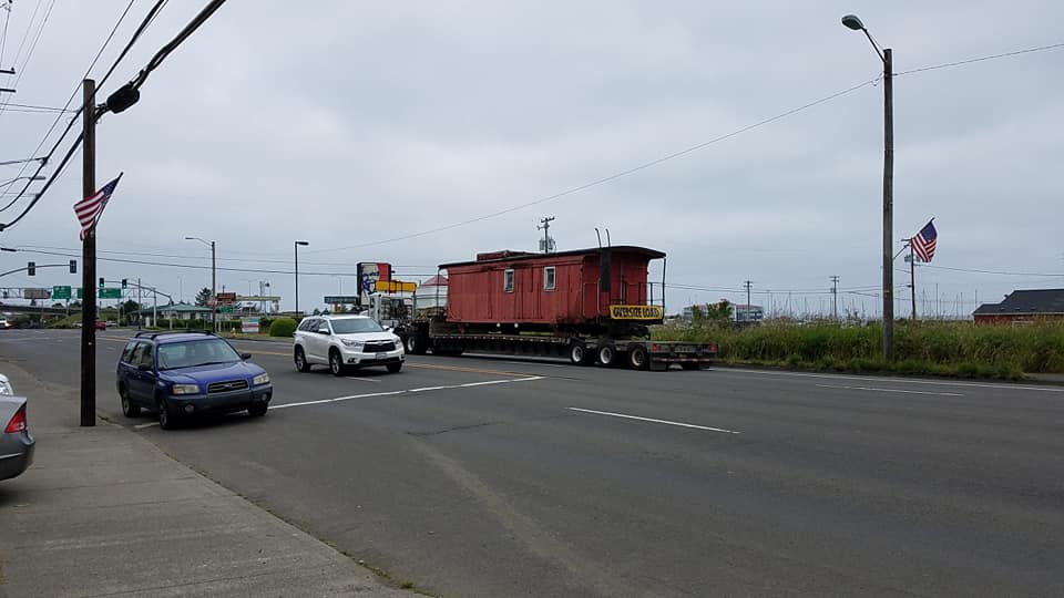

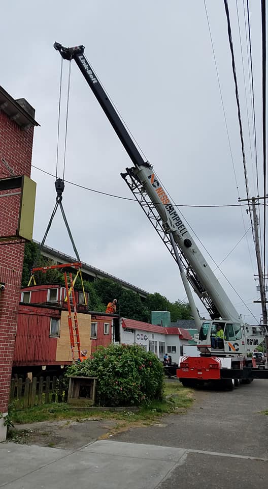

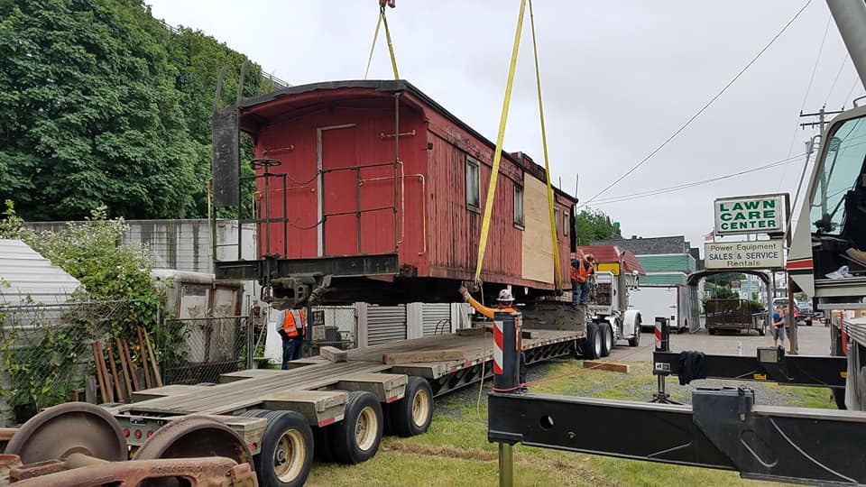

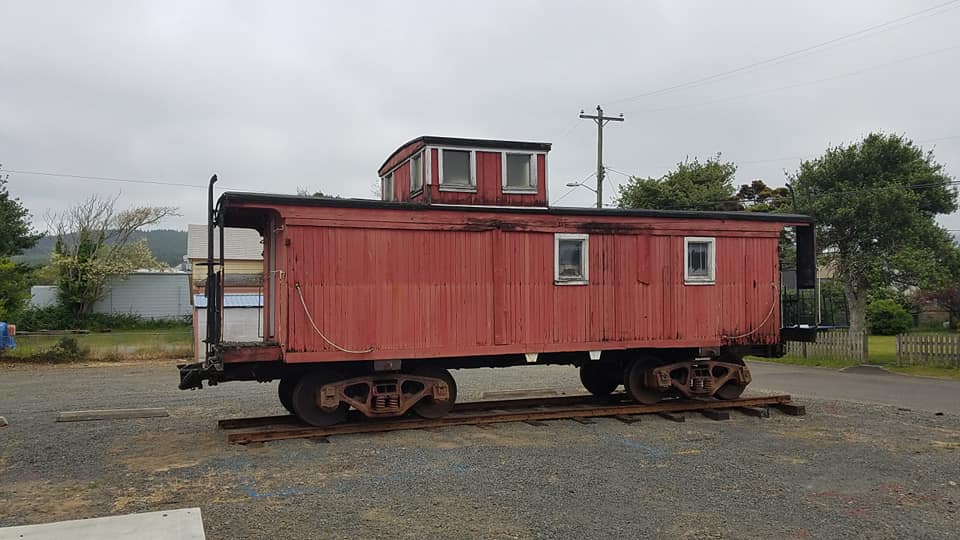

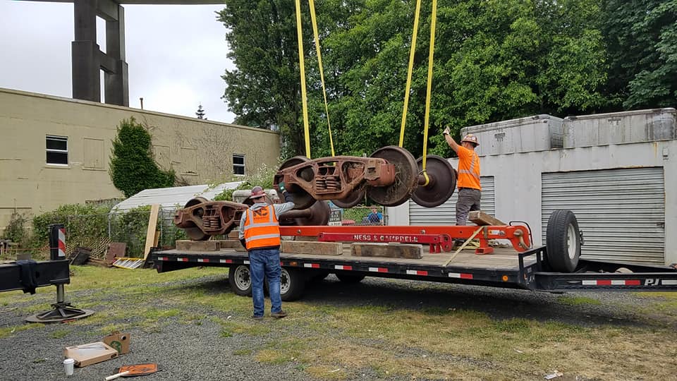

Manufactured by Northern Pacific in 1903 for its subsidiary SP&S OE Railway for use on the Willamette Valley Line between Portland and Eugene and its branches. Looking for any information on its construction and use over the years. Northern Pacific historical and Oregon Electric have been contacted. It spent a number of years in a park in Clatskanie, Oregon before being moved to Astoria where it has resided for approx 30 years. It has found a new home in Seaside, Oregon.

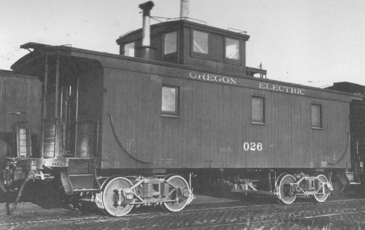

Would the windows had opened originally? The windows on the cupola look like they might have slid open. Any idea as to the purpose of the small platform in front of the cupola? The steps and ladders have also been replaced since 1938.
Just an extension of the roofwalk for better footing on the curved roof.
IIRC there was an ICC requirement (late '40s/50s?) that caboose ladders have grabs that extend above the roof for crew safety.

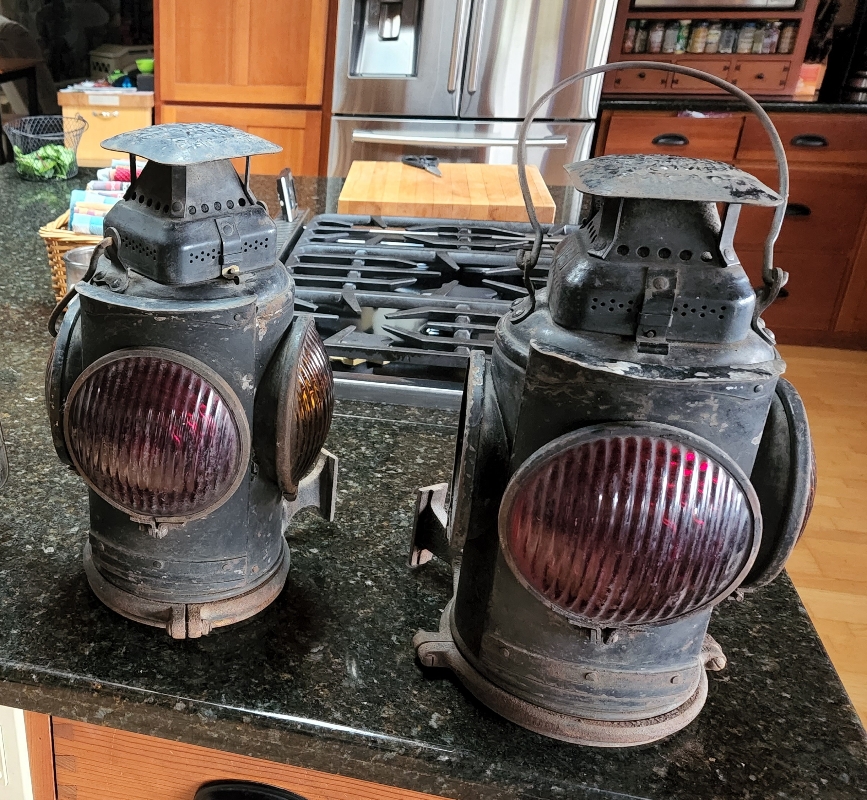

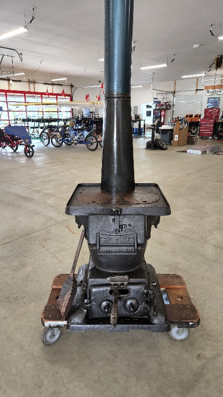

Getting ready for some refurbishment of my caboose! Took some pictures to document its current condition…pretty poor.
Picked up a couple of marker lantern and a stove for the caboose.
The original ice box and sink are intact. Will have to reconstruct the lockers on the opposite side. Conductors desk and one bunk will also have to be reconstructed.

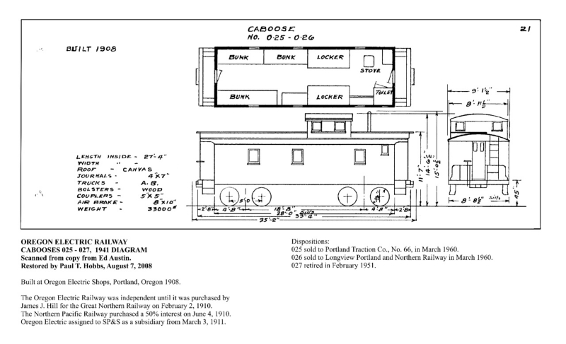

Original diagram

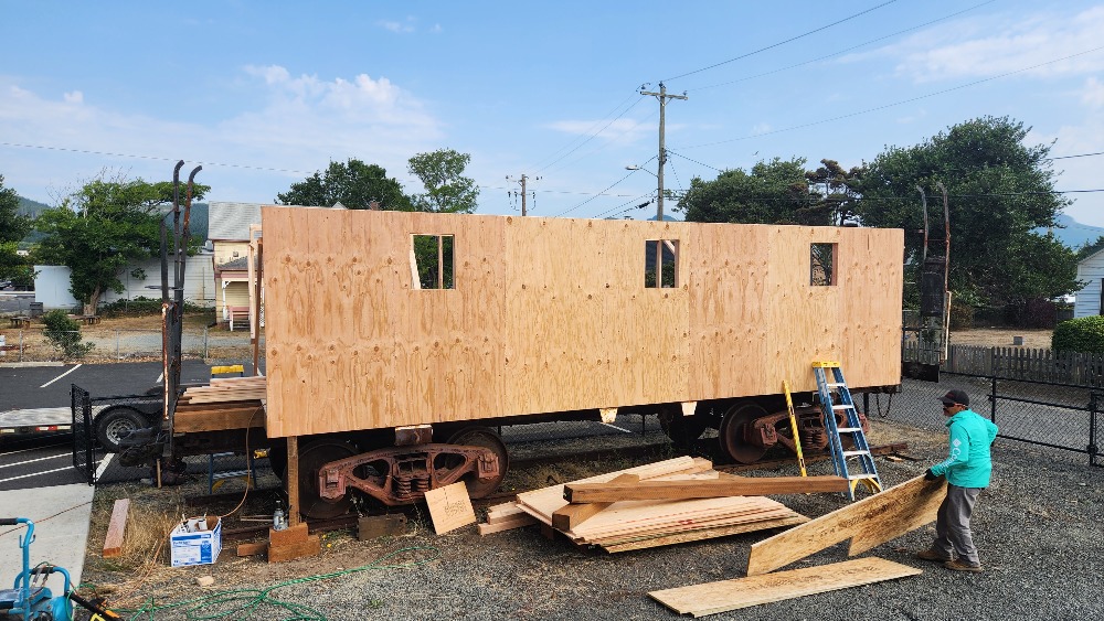

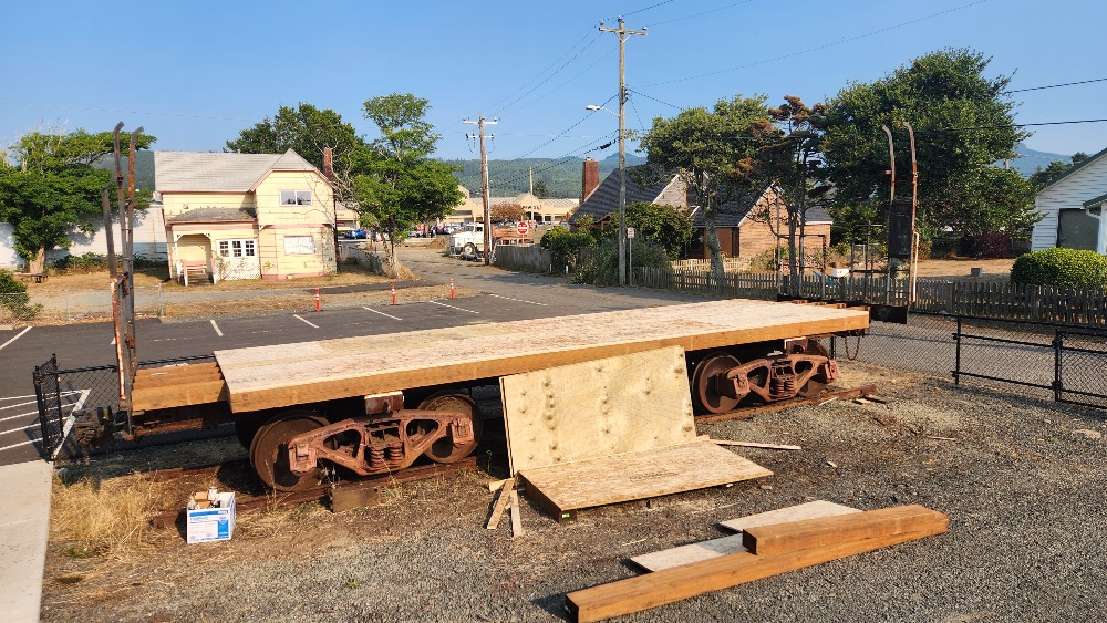

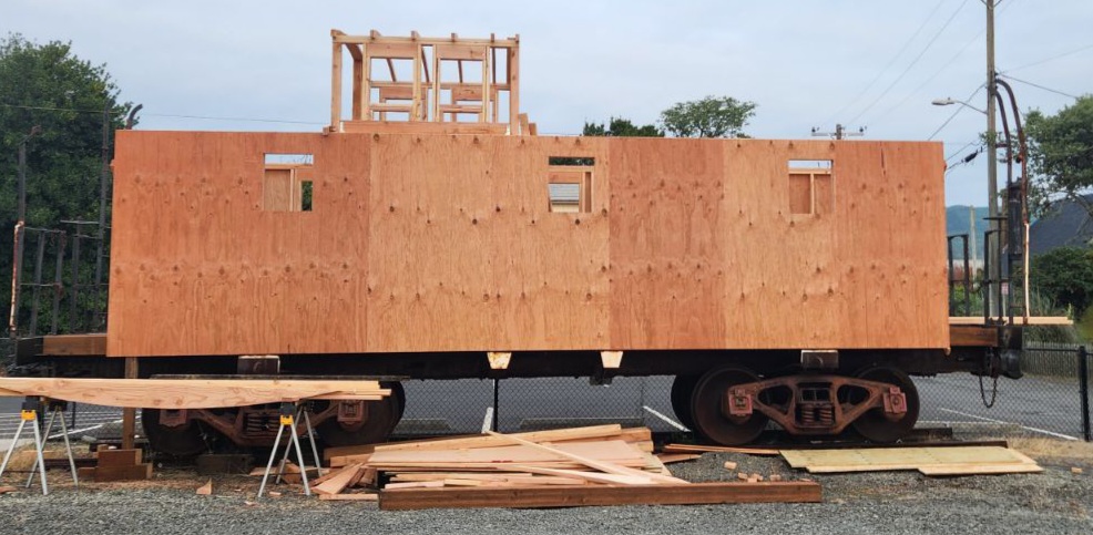

The Pacific Northwest and lack of repair over the years have taken their toll on 'ol 026. We have decided to rebuild the caboose to look like it did in the 1938 photo. We will not be doing a period restoration.

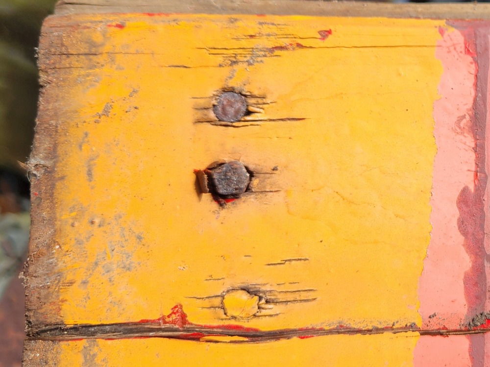

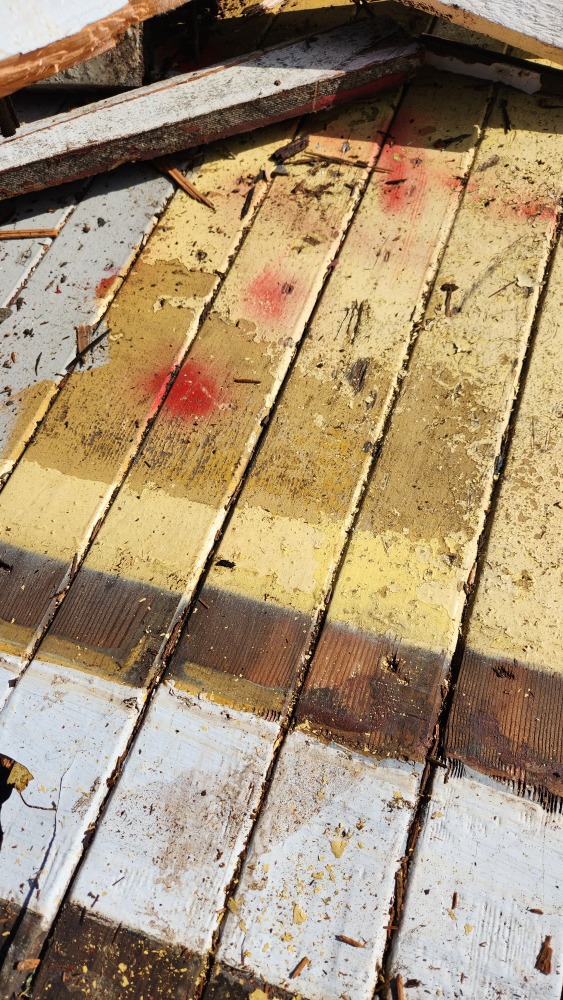

It looks like the caboose was yellow at one time with a light yellow interior.

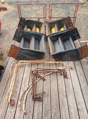

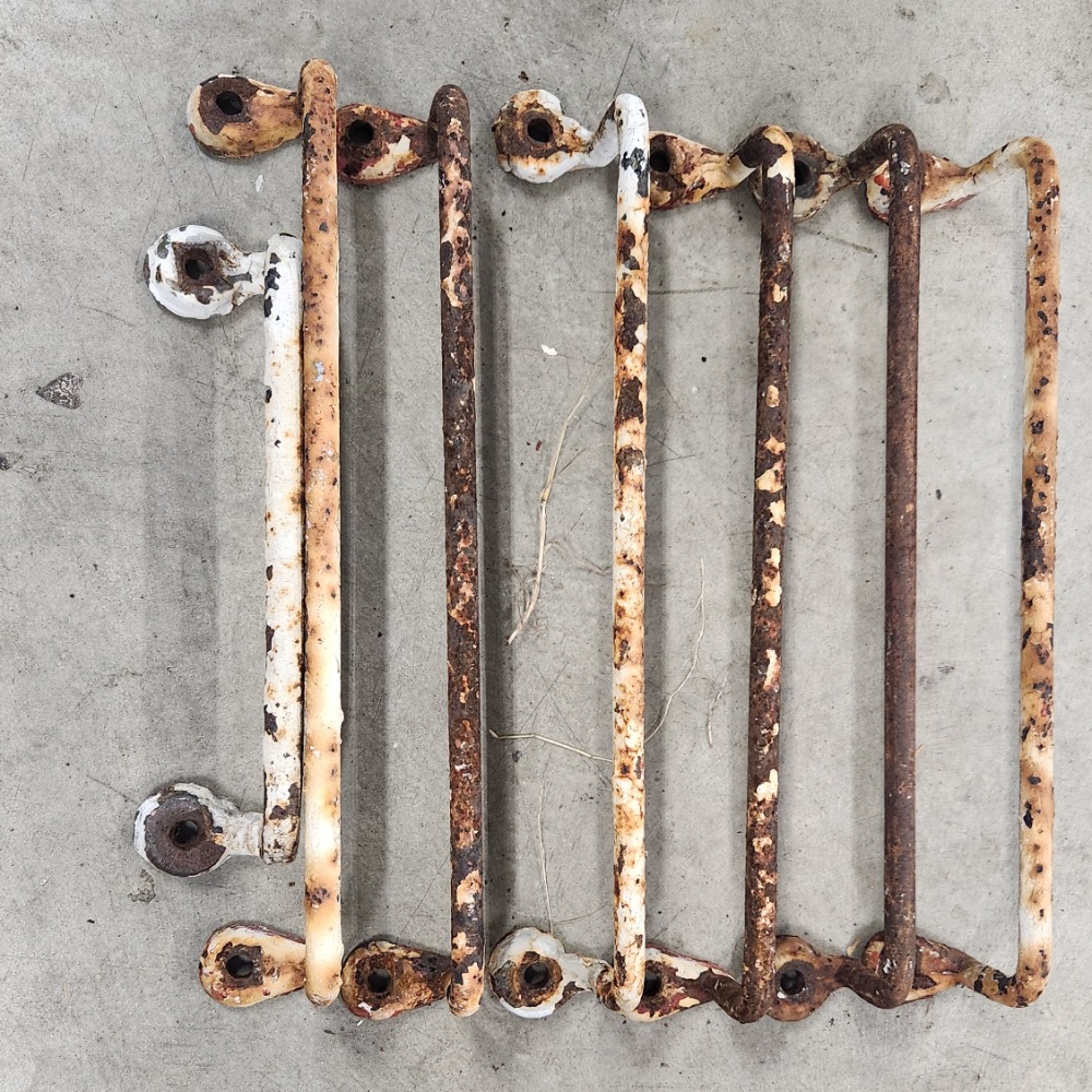

What color would the grab rails been in 1938?

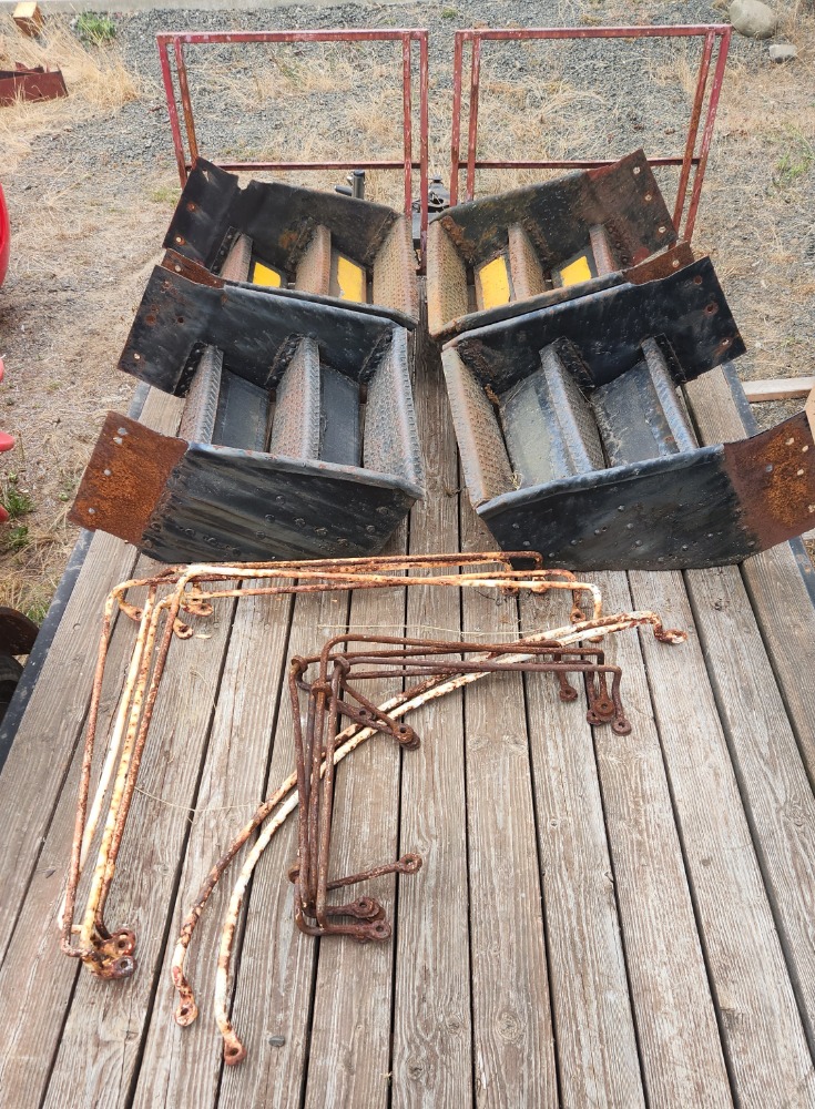

These are too big for my blast cabinet. The steps need some straightening and welding. Will have to have two new grab rails made as they were cut off.

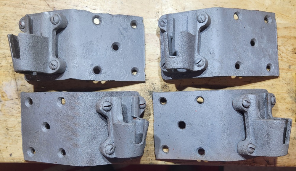

Thankfully the marker lamp brackets survived all these years!

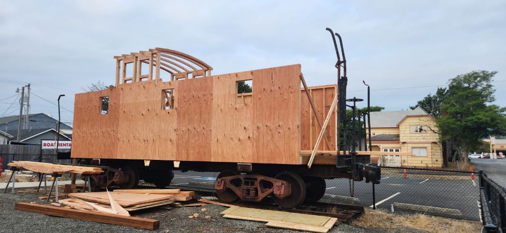

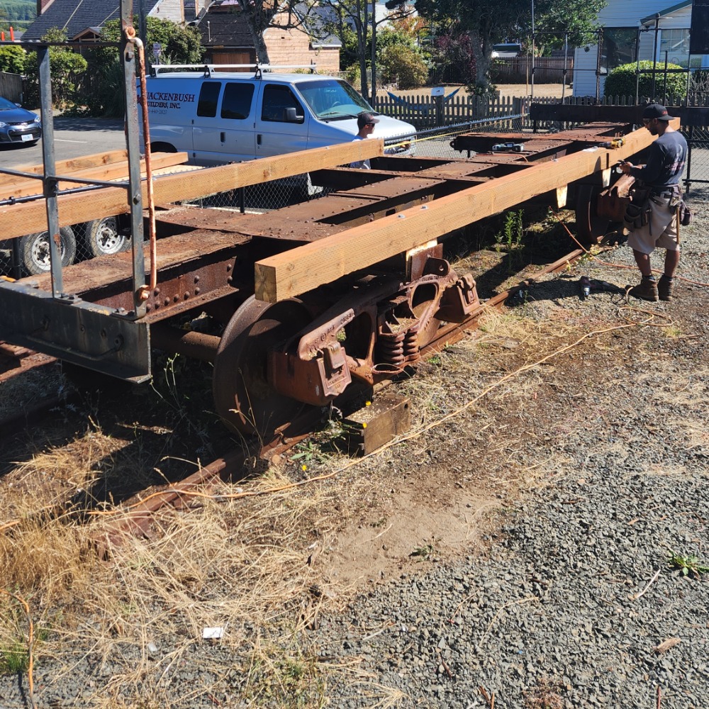

More progress.
