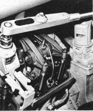

Here is the contents of the OP's attachment. It contained 1 paragraph of text, 1 photo and 2 keywords.
CAUTION: When using a "Powerench", Fig. 4-8, with a tension indicator to tighten the large strong backs, a torque of approximately 1200 foot pounds is required at the nut. A wrench such as the "Powerench" has a gear reduction between the input and output (see nameplate of wrench) thus to obtain the required torque reading of 1200 foot pounds at the nut, 230 foot pounds must be read on the indicator. (Ratio input to output is 1 to 5.2 for the "Powerench" hence 1200/5.2 - 230 foot pounds).
File comment: Powerench on Alco diesel
Torque wrench multipier, mrf-powerench sweeney
