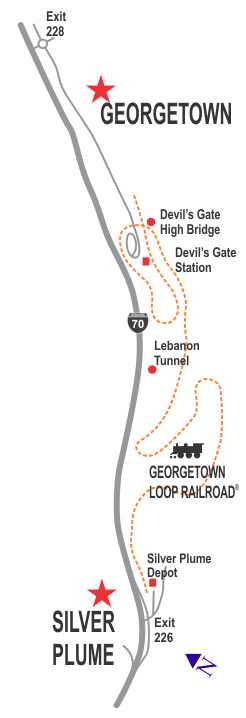

The Georgetown Loop Railroad in Colorado has operated quite happily--and often at capacity and having to schedule people for a later train or turn them away--with a point-to-point operation, runaround tracks at both ends, and a 3-1/2% grade connecting the dots. No turntables; no wyes. In better years the ridership has been up around 120,000. Not bad for a single train making back-and-forth trips a few times a day.
Mike
