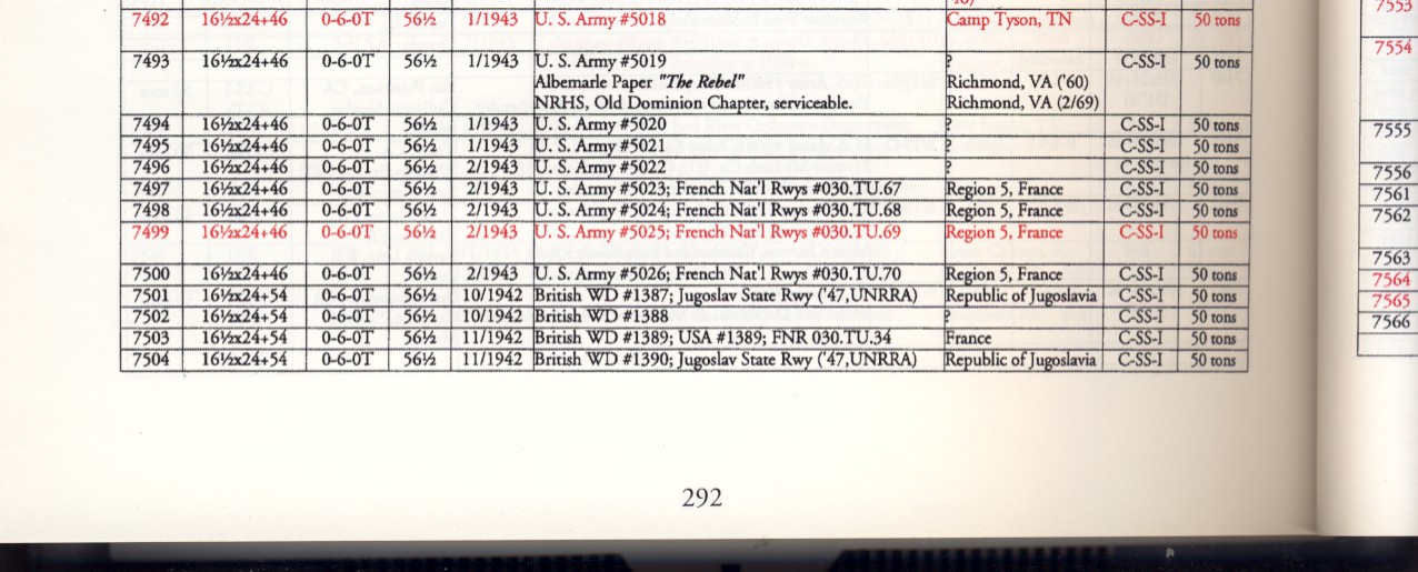

Hi, all:
Would anybody know where an H.K. Porter builders plate could be traced to identify the engine it belonged to? Specifically, builders number 7493.
Thanks,
Steve Hunter
 Post subject: Re: HK Porter Builders Plate ID
PostPosted: Sat Mar 23, 2013 10:43 pm
Posts: 607
Location: Milford,Mass
Hi Steve
This information is from the Porter Steam locomotives Light & Heavy a reprint of the 13Th edition Steam Catalogue published by National Model Railroad Association copyright 2001 .
Now the information on builders plate # 7493 cylinders 16/1/2"+24"+46"
engine 0-6-0T
Gauge 56/1/2"
Build 1/1/43 for U.S Army # 5019 Class C-SS-I 50 Tons
Sold 1960 to Albemarle Paper " The Rebel" Richmond, VA
Either resold or Donate Feb 1969 to N.R.H.S. Old Dominion Chapter , Richmond, VA Serviceable .
This is all the information I have , Pat.

The lists I have say the Old Dominion loco is Porter c/n 7499, not 7493.
Previous threads on this loco:
viewtopic.php?f=1&t=22687
viewtopic.php?f=1&t=22691
SteamLocomotive.Info:
http://www.steamlocomotive.info/vlocomo ... splay=1230
http://www.steamlocomotive.com/misc/ima ... tellow.jpg

Hi Alexander
Well looks like their is a misprint somewhere , again going back to the Porter Book that I mentioned on last post , and also checking my David Conrad books , we have to different Builders Numbers .
Attached is scan from the Porter Book . Pat
I'll ask the fellow who was asking to confirm the number on his plate.
In the meantime, is there a member of the NRHS Old Dominion Chapter on line who could confirm:
a. Whether their engine is wearing its plate(s)
b. If it has plate(s) what number is on them?
I read somewhere that Porter only put one builder plate on each engine, not one per side. Not being a Porter expert by any means, I'm wondering- is this true?
Thanks!
