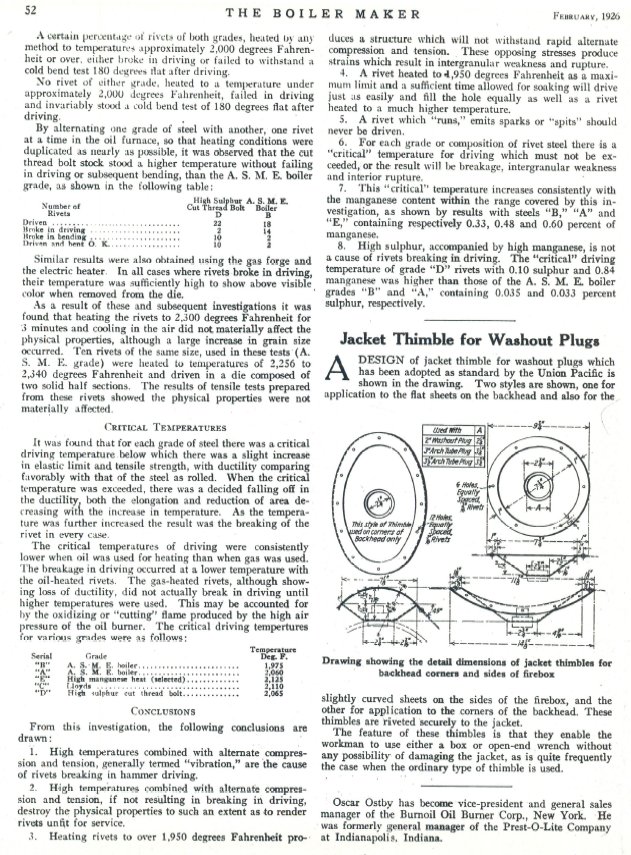

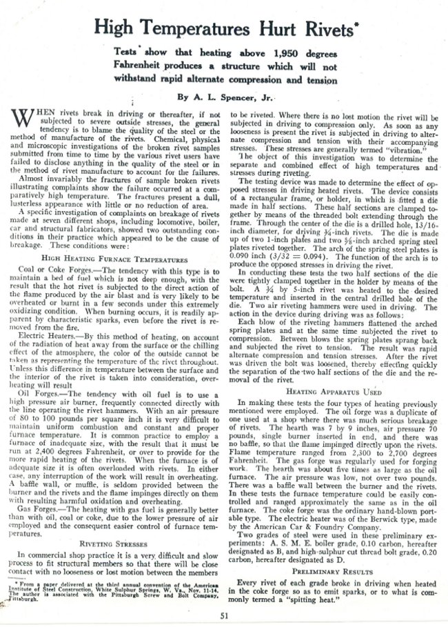

PostPosted: Fri Mar 15, 2013 1:35 am
Posts: 489
Maximum rivet temps....

Interesting article, and worthwhile information...don't drive spitting rivets.

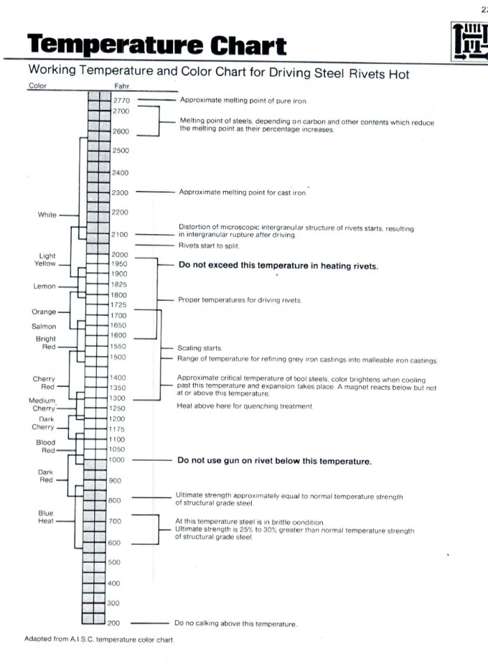

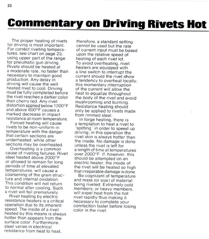

Posts: 489
More temp info...
