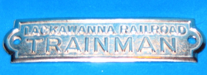

Recently, the Erie Lackawanna Dining Car Preservation Society started the process of uniforming our onboard services car hosts. To that end, we needed to reproduce some of the uniform trappings such as hat badges.
In a former life, I spent about 25 years as a Revolutionary War "living history" person. Within that community are a number of artisans who specialize in small-quantity castings and reproductions. One of these is my former colleague Roy Najecki. Roy has done some exquisite reproductions of uniform hardware from that period, some of which are seen on his website:
http://najecki.com/repro/reproindex.html
Roy was able to reproduce the DL&W Trainman's badge shown in the attached photo for us very economically. If any of you have need of reproductions of uniform items in white metal or brass, I would highly recommend dropping him a line at roy@najecki.com
File comment: Reproduction DL&W hat badge cast from original

That's pretty neat. What process did he use? Did you have to give him an original, or can he work from photos and drawings?

Remember the nature of Roy's Revolutionary War-related business -- all his castings are based on original artifacts, or at least reproduced items provided to him as masters. Our effort to recreate the badge fit that process. Since we were looking for a white metal item, Roy was able to do that completely in-house, which also kept the cost down.
In our case, the original was a stamping. To create a master thick enough to cast reliably, Roy just built up the thickness by filling the stamping with plaster when making the mold - a non-destructive modification easily cleaned off afterward. He then cast the badges in a high-tin content pewter. The reproduction is only slightly heavier than the original, and thanks to the particular alloy, is strong, but capable of being curved to the badge shape. Has a nice "ring" to it if you drop it on the table, too. ;^)
Brass work is done as lost-wax castings, in partnership with Cranston Castings (http://www.CranstonCasting.com), with Roy doing the finish work. As you might expect, prices are a good bit more for anything brass.

Someone asked about making up badges starting only with a drawing of photograph. This would be a perfect application of photo etching.
There are model companies that etch brass, nickel silver, and stainless steel, but these materials typically are only etched a couple thousandths of an inch deep. However, there is still a small market for etched printing plates. These were traditionally zinc, thicker material, and a deeper etch. Last time I had this work done (admittedly, twenty years ago) the plate material was being changed over to a magnesium alloy, which is both lighter in color and more corrosion resistant than zinc. When I saw the Lackawanna badge pictured above, at first I thought it was an etching; it looks just like the magnesium plate material. The etched plate could be used as a pattern for casting, but I don't see the advantage, as the etchings were relatively inexpensive, and given the film and set-up charges will be the same for either one or as many as will fit on a sheet, I don't see any advantage to doing so.
All that should be needed to do the job is full size black and white art for one badge, the etcher should be able to replicate this multiple times to fill the sheet. Traditionally, areas to be left un-etched, like the raised letters, were rendered in black, but I'm sure with the widespread use of computer graphics these days, reversing the colors is no big deal.
As I said, it's been twenty years since I had any need for this, but a quick Google search shows the outfit I used is still around:
Fyco Photo Engraving
100 Woodview Drive
Elgin, IL 60120-6800
(847) 742-5812
Unfortunately, no web site, but the Google search brings up multiple hits for companies that should be able to do this sort of work.

Nowdays, with 3-D printers available, it will be just a little setup work to scan in the original and do the necessary steps to produce the design for printing.
Your choice of plastic or metal.

Furthermore--and actually an angle relevant to this discussion--the gun parts created so far, according to sources I've been reading, DO NOT hold up to repeated weapons use and repeated loadings. They're, thus far, useful primarily to make a point of issue for potential court/legal challenges.
As I've been led to believe, 3D "printing" would be useful, in the context of the above discussion, for making a pattern of a new or recreated design for making multiple castings, but not for making originals to hang on the hat.

Actually, 3DP is a very good way to make a reproduction one-off hat badge in a material that can be done by 3DP. They don't take the mechanical stress one would find an a firearm or other machine subject to wide mechanical stresses and variation.
Of course, stamping is a great way to reproduce things made by stamping, provided you intend to make enough to justify the cost of the die.
