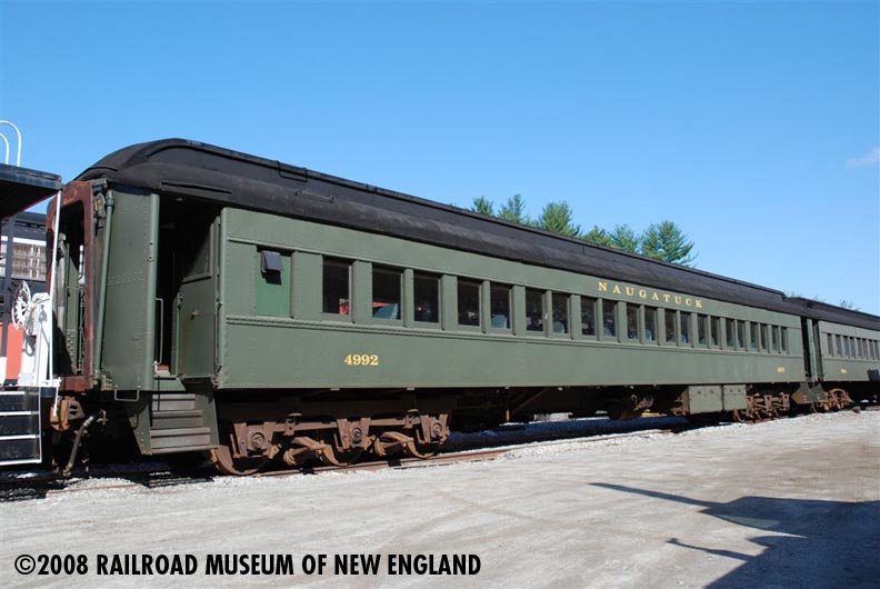

Does anyone have a listing (or personal knowledge useful in creating one) of remaining Canadian National heavyweight commuter cars in use or storage? Attached is a photo of such a car beautifully restored by the RR Museum of NE.

The pictured 4992 now has a rubber roof, which was the subject of some postings here a few months ago--- search for "EPDM roof" and it should come up.
4990 is now in the shop, getting a quick paint job and some roof attention.

4992, the one in the pic, was just released from the shop after over a year of work. It had a rubber membrane roof installed with repairs to the underlining wood roof structure done also.

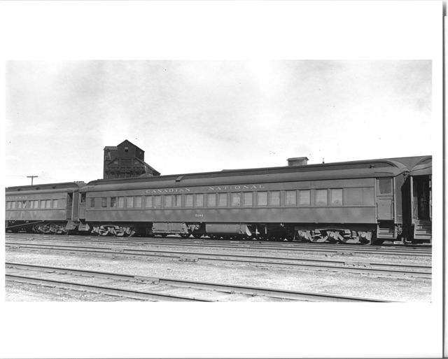

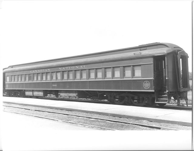

In service images:
Winnipeg, 1948. Note the ice bunkers on the left side underbody.
The 1954 paint scheme. Steps and battery box covers are "Canadian Flyer" style on this car, ice bunkers on the right.

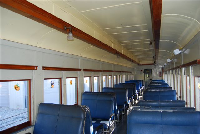

CNR 5046 interior:
New window sash, refinished trimwork. This car is scheduled in for work this winter and spring 2013--- new EPDM roof, vestibule and other repairs, exterior repaint, and baggage racks reinstalled.

That is a nicely redone interior, btw. Will look great with the racks re-installed!
