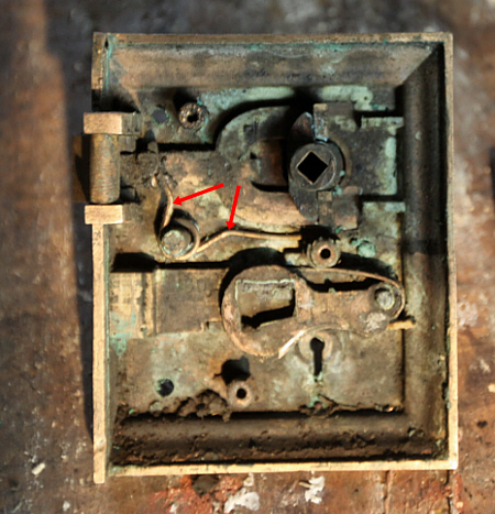

But the springs always won and getting it back together working was usually impossible. Take apart a 1950s windup alarm clock. Oil it up. And see if you can get it back together working. When I had a camera I took pictures as I took the thing apart. Yet the spring always seemed to win. SPRONG!
So on the North Carolina Piedmont I'm now working on a 1922 Southern Rwy Coach that was full of mahogany. The only mahogany left are the two end doors between the passenger compartment and the vestibules. I removed the multiple layers of paint. Found the original color of the varnish. Stained them that color and put on three layers of top-of-the-line spar varnish. They look 90-years-old-beat-up wonderful.
About the spring. The spring shown by the red arrows in the photo below disappeared when I took the mechanism apart. Don't lecture me about being careful. I've done that to myself enough.
How do I replace it? Make a new one? Get you to find or make a one?

Marty your not the only one that has that problem. The spring you are trying to replace is not that hard to locate. The lock you are working on is not uncommon on the inside. I would start looking for box locks at old junk and antique shops also find an old established locksmith you would be amazed what they have for parts. Your last resort is to purchase some spring steel from McMaster & Carr and bend one.

Adams & Westlake, nothing like getting the genuine part. I believe it is still available from them.

These are called torsion springs and can be found on pages 1226 & 1227 of the McMaster-Carr catalog No. 119. We keep several sizes in stock as all door latches are not the same. Trap latches use these as well.
Also found on p. 1227 is a Spring Winding tool. We have one and use it to make odd-ball, one-off springs.
Good luck!
