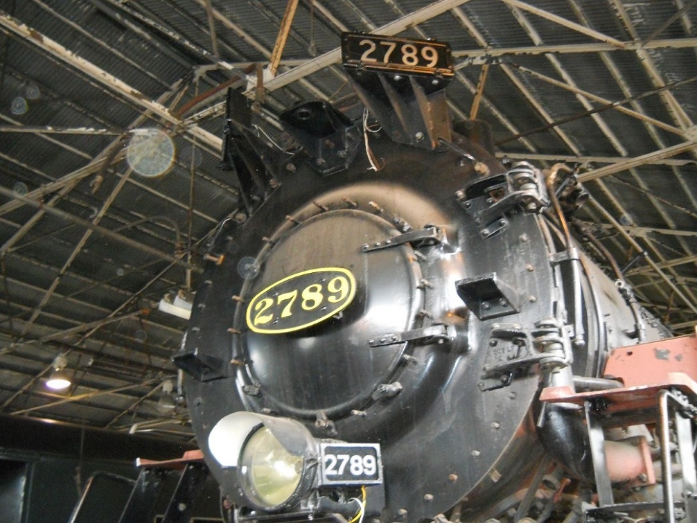

I would think that your best bet would be to contact the Norfolk & Western Historical Society who probably has font style and sizes in their N&W archives. Our C&O Kanawha had the incorrect fonts in both the lamp boxes (at the top of the 2-8-4's boiler) and in the headlights. Jeff Kehler of the C&O Historical Society, after a long search in their archives, was able to furnish the correct fonts for both. The photo below shows the correct font as applied into the lamp boxes. The headlights still have the incorrect fonts, but those will eventually be changed too.
