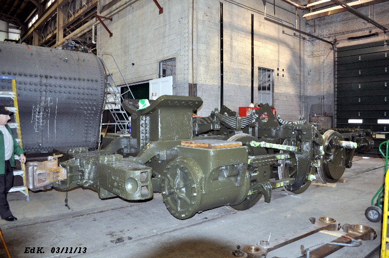

She'll look great in her original dark green coat.

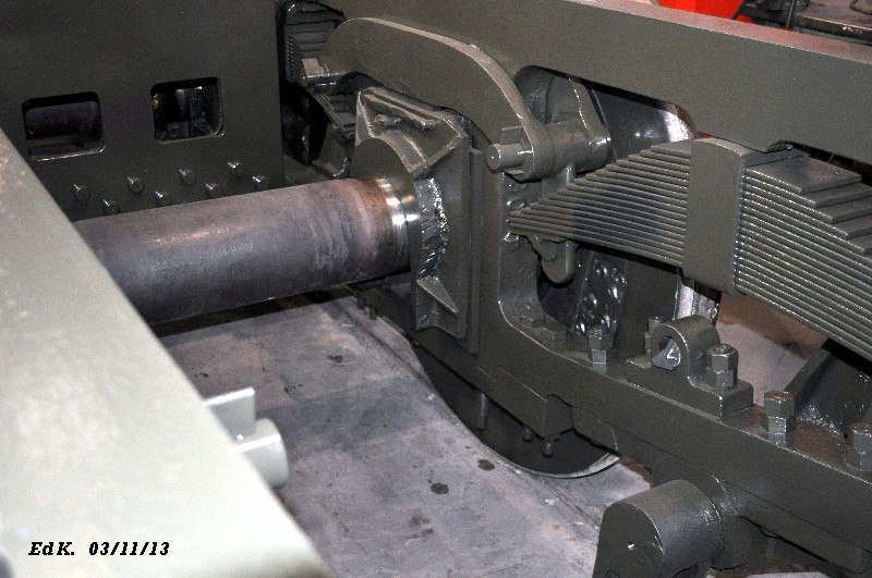

Yup! I think I'm digging that green. Did you notice the modern touch done to the journals?
 Post subject: Re: Baldwin 26 part two
PostPosted: Tue Mar 12, 2013 4:21 pm
No, what is it?
PostPosted: Tue Mar 12, 2013 5:33 pm
Posts: 528
Location: New Jersey, Central
Look at the top of the journal on the inside. :)
PostPosted: Tue Mar 12, 2013 6:06 pm
Sorry, I have no idea what to look for.
PostPosted: Tue Mar 12, 2013 6:41 pm
Joined: Tue May 25, 2010 8:57 pm
Posts: 80
Location: Bozeman, Montana
Forgive my ignorance, but am I looking at a weld? Or is that just the edge of the metal (where Steve is talking about the journal)?

Grease gun fitting?

Nothing modern about the lube lines, 2102, 759, 3713 and others at the park have them, just a maintenance upgrade for 26.

Mike for 26 that in my book is a modern touch. I think it's a very smart and well thought of idea. Should save some work down the road. The shop added oil lines to the top of the journals to help with lubrication. I'm not sure if it will be pressurized or not. Eitther way the shop workers have thought ahead to ease their work load. :)

Only the center one goes to the journal, the outer ones are for the shoe and wedge. The 26 was built with oil cellars, originally equipped with waste packing. The waste and or pad has been replaced with an Armstong Oiler arrangement built by some very fine gentlemen from across the pond. Initial thoughts are of using a one shot oiler system (along the lines of a Bijour) for the journal bearings at the start of each day and a small mechanical lubricator for the chassis lube.
