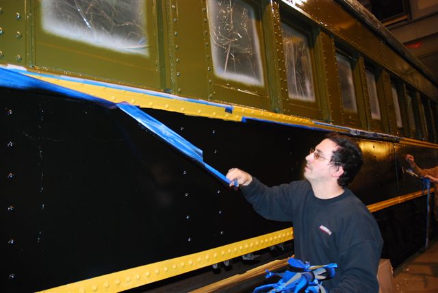

Jason Hartmann peeling masking tape off CNR 5114.

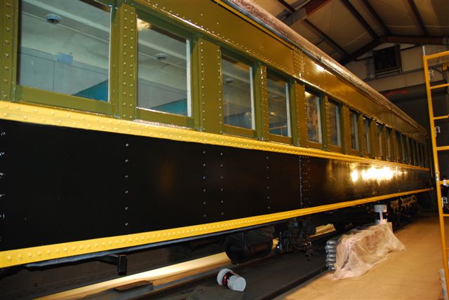

We had CNR decals made from 1954 blueprints; this is an earlier sample placed "for effect" after the lower masking was removed. The final decal has a better yellow match.

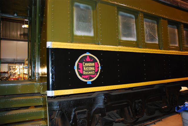

Middle of one side-- masking is off the windows and it starts to look quite spiffy. The interior was painted last year. Car was numbered 4990 while in Montreal commuter service, and we returned it to the original number of 5114. The CNR coaches at RMNE were a very generous donation in 1997, from a long-time supporter and friend of the Museum, Thomas V. Brown.

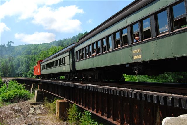

4990 was our probably our crummiest-looking operating car; it was simply referred to as "The Beater". This photo shows it mid-train crossing Jericho Bridge behind Flagg Coal 75 in June 2012. About 10 years ago, the CN light gray letterboards and lower sides were rollered with dark green.

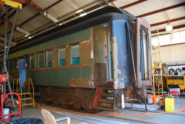

4990 in Thomaston Shop, August 2012. Needlescaling of old paint has commenced around windows, belt rail and in vestibules.

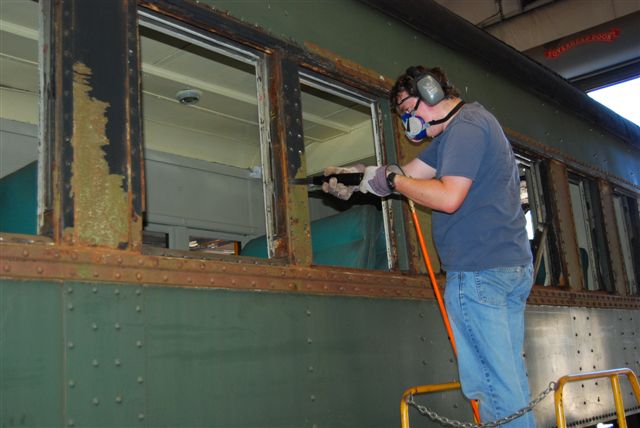

RCD scaling the east side window posts and belt rail. Window sashes are out for repair by carpentry dept.
