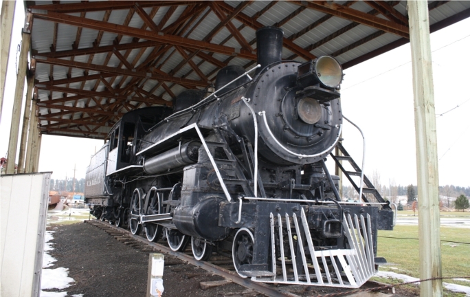

Here's how she looked in 1984: http://www.srv.net/~rstewart/wim/equip/wim1.jpg
I'm guessing that the locomotive's boiler jacket rusted through in the 1980's, and was patched when she was cosmetically restored about 10 years ago. I'll have to check for sure, but the jacket doesn't appear to be rusting through. If the asbestos was wet, I would think that the jacket and the patches would be long gone by now.
As for the city funding asbestos removal, the city has a population of 800. It's an old mill town. I don't think the funds exist. Trust me, I'd love to get that asbestos outta there, but I don't see any possible way.
Any ideas?
File comment: Here's how she looks today.

Second Jeff's motion; I got a few nice in-kind donations for restoration projects in small cities.
OK, if you can't do it right, do the rightest job you can. Problem is open circulation removes moisture, but carries friable asbestos. My guess is you are going to trade off conserving the jacket and boiler shell for encapsulation. The boiler may be a total loss anyhow; it isn't a very rapid process under roof in any case.
Use whatever you can get locally that makes sense, but with the awareness that it will be a stopgap short-term solution, and will need occasional patching over the years.
