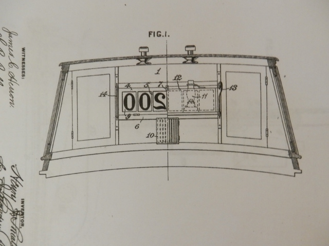

These were stencil numbers that were used in front of milk glass displaying the train number in the middle window of the caboose cupola, the sole reason for the smaller middle window front and back, they were a six number board e.i, X-0000. The had a opening reflector case with two small hurricane lamps inside to light the displays.

attached is the patent drawing of what we are talking about, thanks to an RYPN contributor to a previous post about the indicator boxes.
