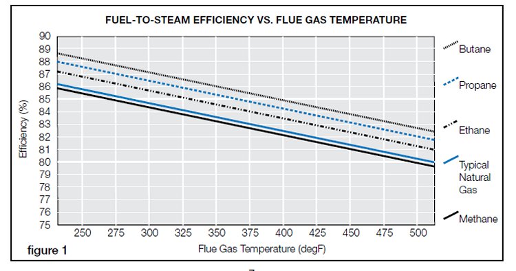

From the Cleaver-Brooks Efficiency Guide (Link) This deals with gas fuel with various H/C ratios for simplicity.
Figure 1 shows flue gas temperature vs theoretical fuel-to-steam efficiency. This table represents the maximum theoretical efficiency you can achieve at a given flue gas temperature. The table can be used as follows. If a boiler is represented to be 85% efficient firing natural gas, follow the 85% on the left to the natural gas line and down to the flue gas temperature. The result is approximately 270 deg.F. This shows the boiler would have to operate at a 270 deg. F. stack temperature to meet the 85% efficiency, or the efficiency calculation was based on an unrealistically low hydrogen content fuel. If a boiler is represented to be 85% efficient on natural gas at a 350˚ F stack temperature, check the fuel specification. A Boiler cannot operate at 85% efficiency at 350° F stack temperature when firing natural gas per Figure 1.

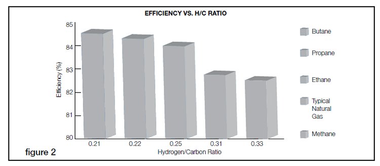

2. Fuel specification
The fuel specification can also have a dramatic effect on efficiency. In the case of gaseous fuels, the higher the hydrogen content, the more water vapor is formed during combustion. This water vapor uses energy as it changes phase in the combustion process. Higher water vapor losses when firing the fuel result in lower efficiency. This is one reason why fuel oil fires at higher efficiency levels than natural gas. To get an accurate efficiency calculation, a fuel specification that represents the jobsite fuel to be fired must be used. When reviewing an efficiency guarantee or calculation, check the fuel specification. Is it representative of the fuel you will use in the boiler? The representation of efficiency using fuel with low hydrogen content will not provide an accurate evaluation of your actual fuel usage. Figure 2 shows the degree to which efficiency can be affected by fuel specification. The graph indicates the effect of the hydrogen-to-carbon ratio on efficiency for five different gaseous fuels. At identical operating conditions, efficiencies can vary as much as 2.5-3.0%, based solely on the hydrogen-to-carbon ratio of the fuel. When evaluating boiler efficiency, knowing the actual fuel specification is a must.
