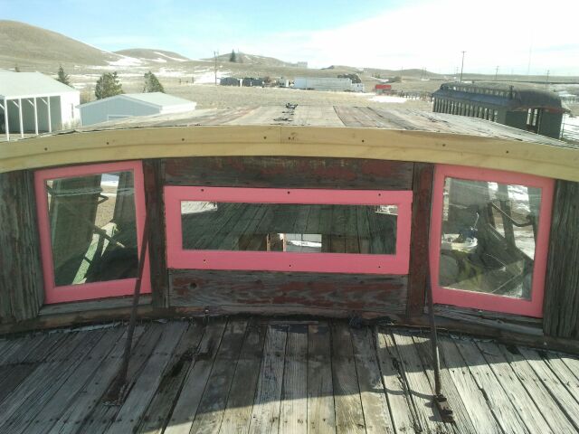

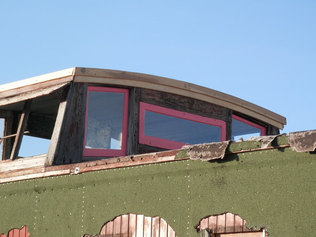

Attached is a latest shot of the caboose with its lovely windows going back in, these are all restored/rebuilt not new or replacements. If you look in the background Car 57 can be seen.
Not a bad year for a one man band

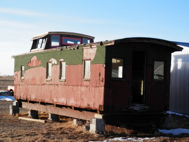

Fitted two more Cupola windows this afternoon and did some investigating into how the side windows slid, appears that a long gone wooden/or metal track was bolted on below the windows. The West door is almost ready to be re-fitted this was just a poor kicked in frame but has come up really well.

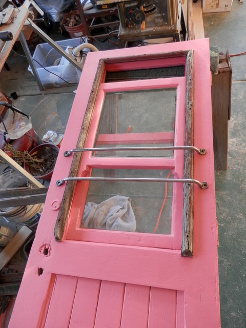

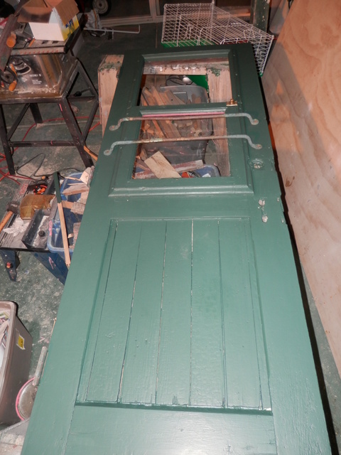

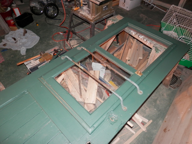

Couple of pictures of the door and its hardware, it awaits the fitting of the drop light window and door handles. The wood in the bottom half is recovered and trimmed from the rotten boards on the Cupola between the side windows....i hate throwing anything away !

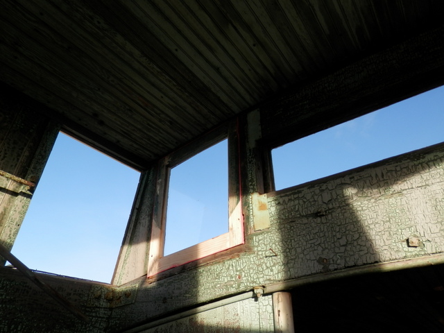

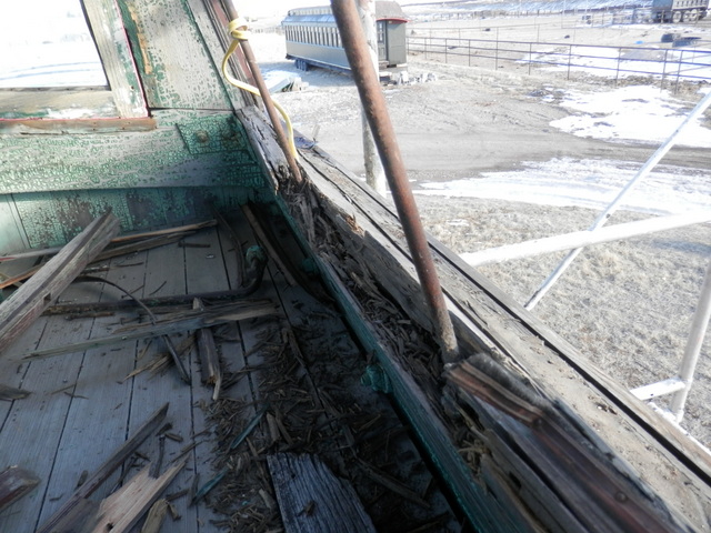

Did some more work today as its spring like here, and started to tackle the rotten wood below the cupola side windows, this will be cut out and a new piece inserted to replace it.
Then the new centre section from 1909 CA 2455 and the side windows can go back in, the guide rails for the windows are being made by Wasatch RR contractors, great having a fabulous crew and shop like that in town.

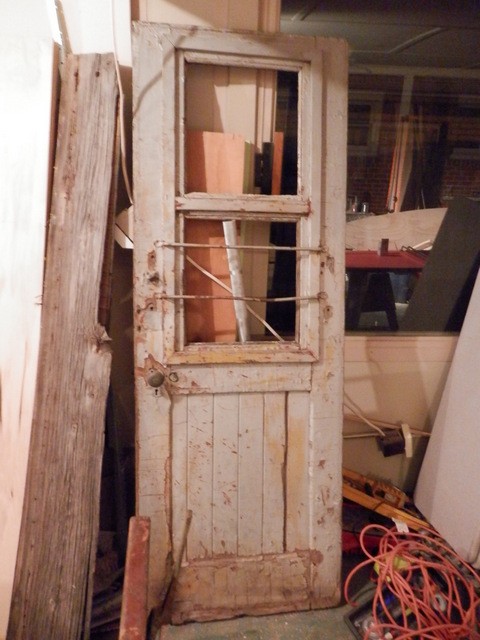

The door continues to make great progress and is almost ready to fit, in view of the time these abused doors take i will fit a replacement door from 2455 on the other end to speed things up.
