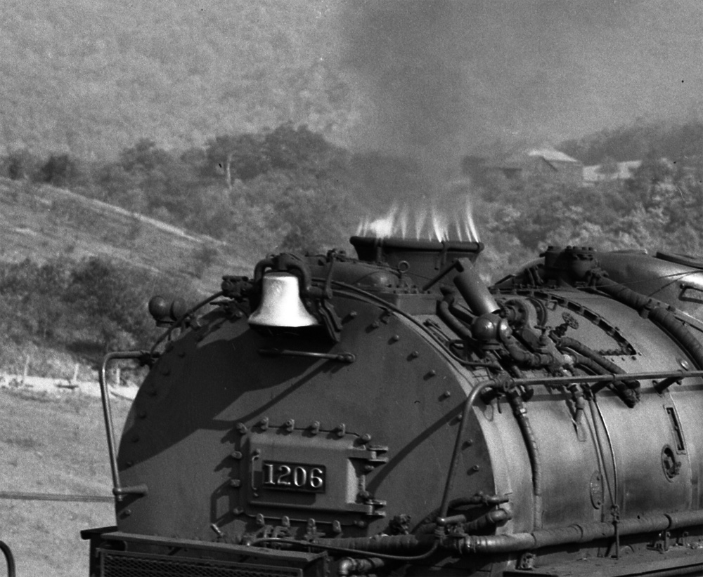

Since many steam experts are here I thought someone could add information to this photo?
Thanks

Two possibilities, as I see it:
Some form of a blower, which is usually located inside the smokebox and is designed to have the steam jet fill the stack lower extension opening ("petticoat pipe") completely, while below the top opening of the stack.
Or, an experimental (?) shop-made form of smoke lifter nozzle.
I would tend to guess the second item. WM's Hagerstown Shop was known to make mods to both steam and diesel power.

I'm inclined to think it's a blower arrangement of some sort, and it wasn't unique to the WM. There is a well known photo around of the first PRR K4s, with a similar steam pattern at the stack.

First I do agree with you , it is some sort of experminal stack , also as and experminal , could have been poor mans elephant ears , to blow smoke out of engineer's way ??? Just a guess???????????? Pat

Interesting- the first photo that J3a-614 posted and the Baldwin builder's photo in "Steam's Finest Hour" show that these engines were originally built with twin stacks. The photo at the top of the thread shows the "experimental stack" is a single unit.
Does anyone know if all the WM 4-6-6-4's were similarly modified?
My bet is the ring of steam jets served as a "smoke lifter" rather than a blower. (Like Pat says- "poor man's" elephant ears.) Their location wouldn't induce much, if any, draft in the stack, but they would propel the exhaust upward somewhat, helping to blow it clear of the boiler and cab.

WM's M-2 4-6-6-4s were handsome locomotives, but I understand they were something of a disappointment, reportedly hard riding and not quite as capable as the big Decapods they were supposed to replace. Built by Baldwin in 1940 and 1941, I always thought they resembled in a way the B&O's EM-1 2-8-8-4s that would follow within the next few years.
This lackluster performance was due to incredibly small and oddly placed exhaust nozzles. Just kidding... It does appear to be a blower of sorts. Perhaps by moving the blower to the top of the stack they thought they would get better draughting as a result.

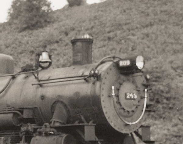

Some of the WM's K2's were equipped with this "blower" arrangement as well. From what I can tell they were added to the remaining coal burning K2's when the rest were converted to oil. Sorry for the so-so quality pic, but it was the best I had showing the arrangement that I already had on my computer. I know I have a better one in print I may try to dig out.

Any possibility they are exhausts from a lubricator or other appliances? 6167 has a couple of small pipes along the stack, one an exhaust for the mechanical lubricator, the other exhausts from oil skimmers installed on the feed water heater

you could never induce serious draft like that, the engines would already have blowers for that. I can't think of the elephant ear use much before the superpower steam era. It seems to be a late invention, NKP experimented with versions on their hudsons and came out with a large bladed one final.
Smoke lifting sounds most practical, but with large power engines you get plenty of lift, (note big boys had them too) but why waste the steam when you need it for power...erm, well, hence the elephant ears I presume.
many lubricators were mechanical, but whatever small devices needed exhausting looks like it would be more wise to chute it up with the stack talk.
Probably when the engines get around stations, populated areas you kick the lifters on, or whenever needed.

Spot on Howard. I knew I had read of something similar in my book on the Merchant Navy-class of 4-6-2s in the UK. Before the class was modified with smoke deflectors alongside the casing of the engine (prior to the BR-era rebuild) Oliver Bullied had designed a similar device for use on the class. One of the first ten was supposedly modified with a similar device in an attempt to prevent smoke drift due to the arrangement of the blast pipe and chimney. Reportedly, the deviced did not work well, and wasn't replicated. I'll have to go back and dig out my copy of The Southern Pacifics when I have a chance so I can check.

I knew I had read of something similar in my book on the Merchant Navy-class of 4-6-2s in the UK. Before the class was modified with smoke deflectors alongside the casing of the engine (prior to the BR-era rebuild) Oliver Bullied had designed a similar device for use on the class. One of the first ten was supposedly modified with a similar device in an attempt to prevent smoke drift due to the arrangement of the blast pipe and chimney......
You can see the Merchant Navies smoke trailing over the Cathedrals Express at 1:18 in video. It appears there is a low pressure area or other aerodynamic disturbance in front of the chimney pulling the exhaust forward.

An interesting topic, if a bit of "trivia". I have noticed this outside smoke lifter ring in many pictures of (gorgeous) Western Maryland steam power in later years.
It would be interesting to know why the WM decided to apply this device seemingly wholesale to their power towards the end of the steam era.

Are you sure those aren't water jets to quinch hot cinders and prevent trackside fires?
